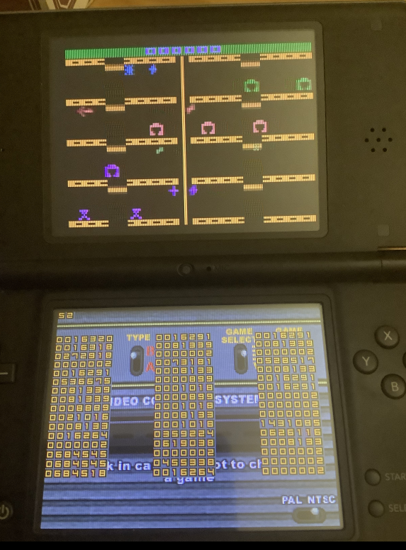

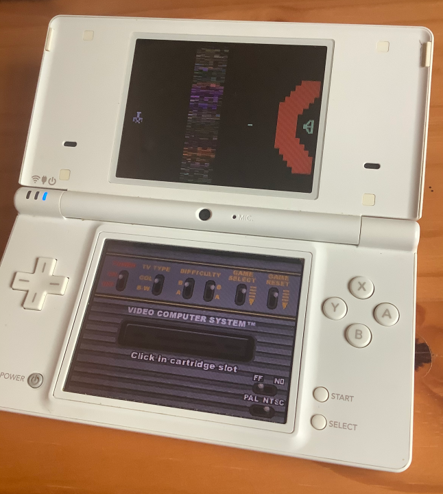

So this weekend I got my development environment setup (on Ubuntu) and got to work. I've made the following improvements:
  • Removed Color TV switch and replaced it with a difficulty switch (stetting A/B renders the difficulty for both Left and Right player switches - I'll probably improve this later). I realize a few odd games do use the Color switch in gameplay... but far more use the difficulty switch and StellaDS was defaulting both switches to the A=Expert position. Until I can add all switches, this is a reasonable trade-off.
  • Used a bit more of the DSi screen resolution so that the occasional missing graphic doesn't get compressed away (e.g. if you fire the laser in Chopper Command you can see it sometimes disappears at certain vertical positions of the Chopper... this is no longer an issue). Generally this results in a few missing rows of pixels at the very bottom of the screen which is a better trade-off for 95% of games where almost no action takes place at the extremes.
  • Fixed all the on-screen touch button handling such that it's not so glitchy... press SELECT switch or START switch and it actually works every time (it's amazing what a little debounce code will do!). I increased the hot-spots where you can press for each switch so that you can cleanly operate it with a finger or thumb... I hated getting out the Stylus for the small hit-boxes that were originally used.
  • Improved the emulator core to handle the most common half-dozen instructions first and in special order plus re-ordered a bit of the math-y code to make computations slightly faster ... this gives about 10% speed up and most games now run at 60FPS or reasonably close to it (on a DSi running 137MHz... no idea on an original DS where I assume this emulator would still be on the struggle-bus).
  • Start and Select buttons now map to RESET (often used to start a game) and SELECT switches. That only seems logical. I remapped the FPS display to the right shoulder switch. I also only output the FPS once per second instead of the wasteful 60x per second which means you can run with the FPS enabled with very little (but not zero!) impact on emulation.
  • The left shoulder switch runs the game at max speed... but since this emulator is running pretty much full-bore already, it doesn't have a huge impact (for example, you can see the ships in space invaders moving at about 10-15% faster than normal ... hardly worth getting excited about - this was mostly for me to see improvements in core optimization).
  • The Power Off button no longer makes that hideous screeching noise. And if you decide not to quit, it renders the screen back properly.
Before I decide how to create a github account and get these changes checked back in - is this stuff of any value to anyone?! Sometimes I feel like I'm the only guy that was bothered by the glitches given the lack of any discussion on this ancient system emulation!

Stella DS 1.1e released. Binary and source: https://github.com/wavemotion-dave/StellaDS
I've eeked out another 1-3% speed improvement on bank-switching optimization. Amazing homebrew games like Man Goes Down and Lady Bug will run full speed. I started a compatibility table as well to track what needs improvement - most games will run well beyond 60 FPS if you open the throttle.
I'm starting to look at correcting as many games as possible. This 1.1e release makes playable those half-dozen games that use the right-player joystick port for a single player (Surround, Air-Sea Battle, Basketball, Wizard of Wor, Space Ship, Slot Machine) and I've added support for Raiders of the Lost Ark which requires 2 joysticks (but the other joystick is only used to select and drop items... that's now handled with the previously unused X,Y and B buttons).
I plan on adding SaveKey support for the "new" (well, since 2006) homebrews that allow saving options and high-scores. And then paddle support via touch-screen.
There are still a handful of games that won't run right... most notably Starpath Supercharger games which I haven't taken the time to investigate yet. Also, Pitfall II is only running at 45FPS and the music is crappy... so it's not all roses. There is also a seldom heard brief "screech" of audio as if something is briefly out of sync... it's minor but annoying. It was present on the original StellaDS and nothing I've done has made it better (or worse). Anyway things are generally improving!
