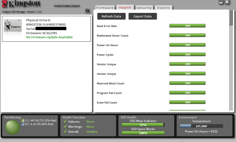

I use 3 SSD on the regular. 2 Kingston 480GB SDD. One as my boot drive for my main PC and one in my laptop a Thinkpad T430. Both have been used for about a year now and still show Good in crystaldiskinfo and show 98% life.
