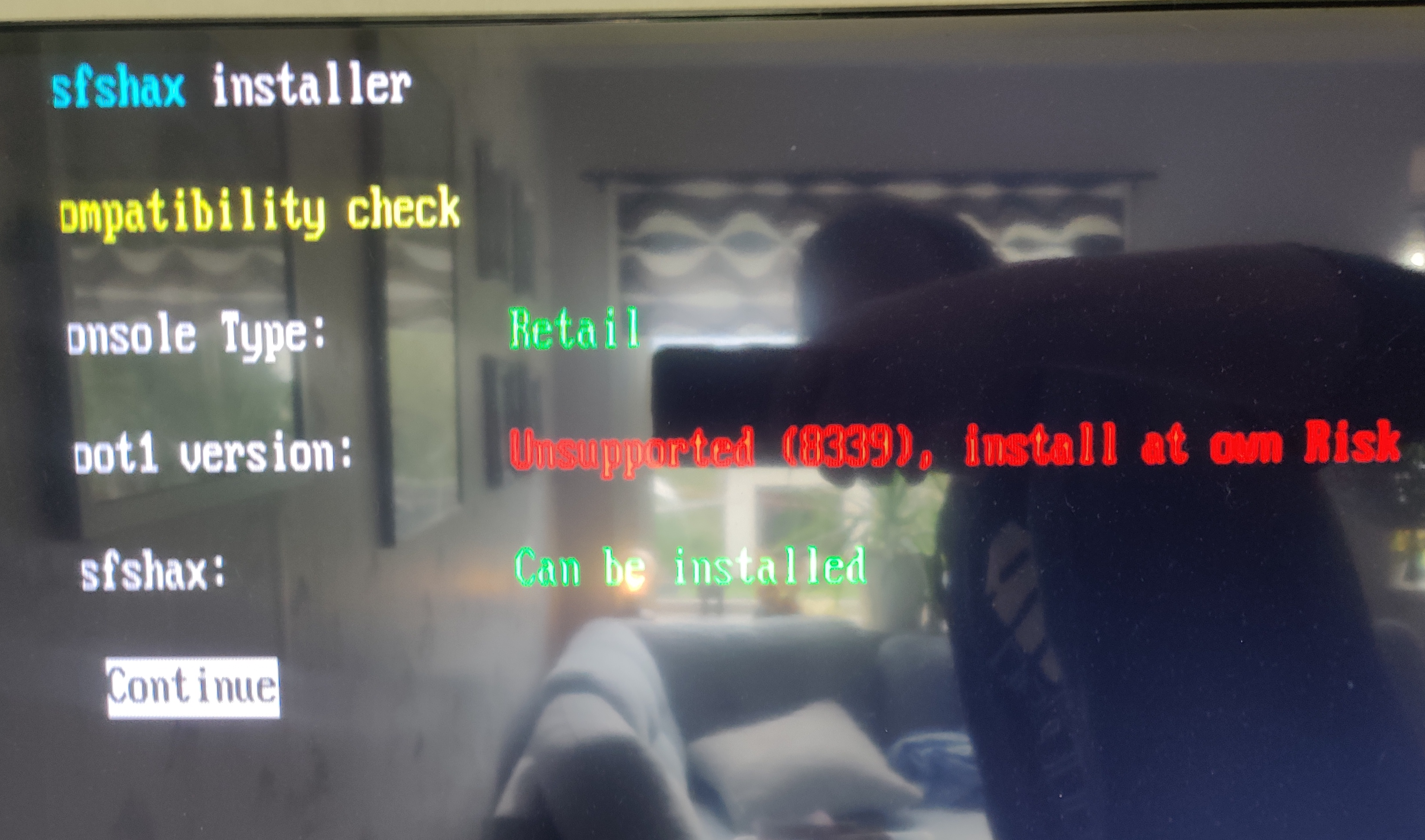

Is there any way to get it to work with v8339 that i have?

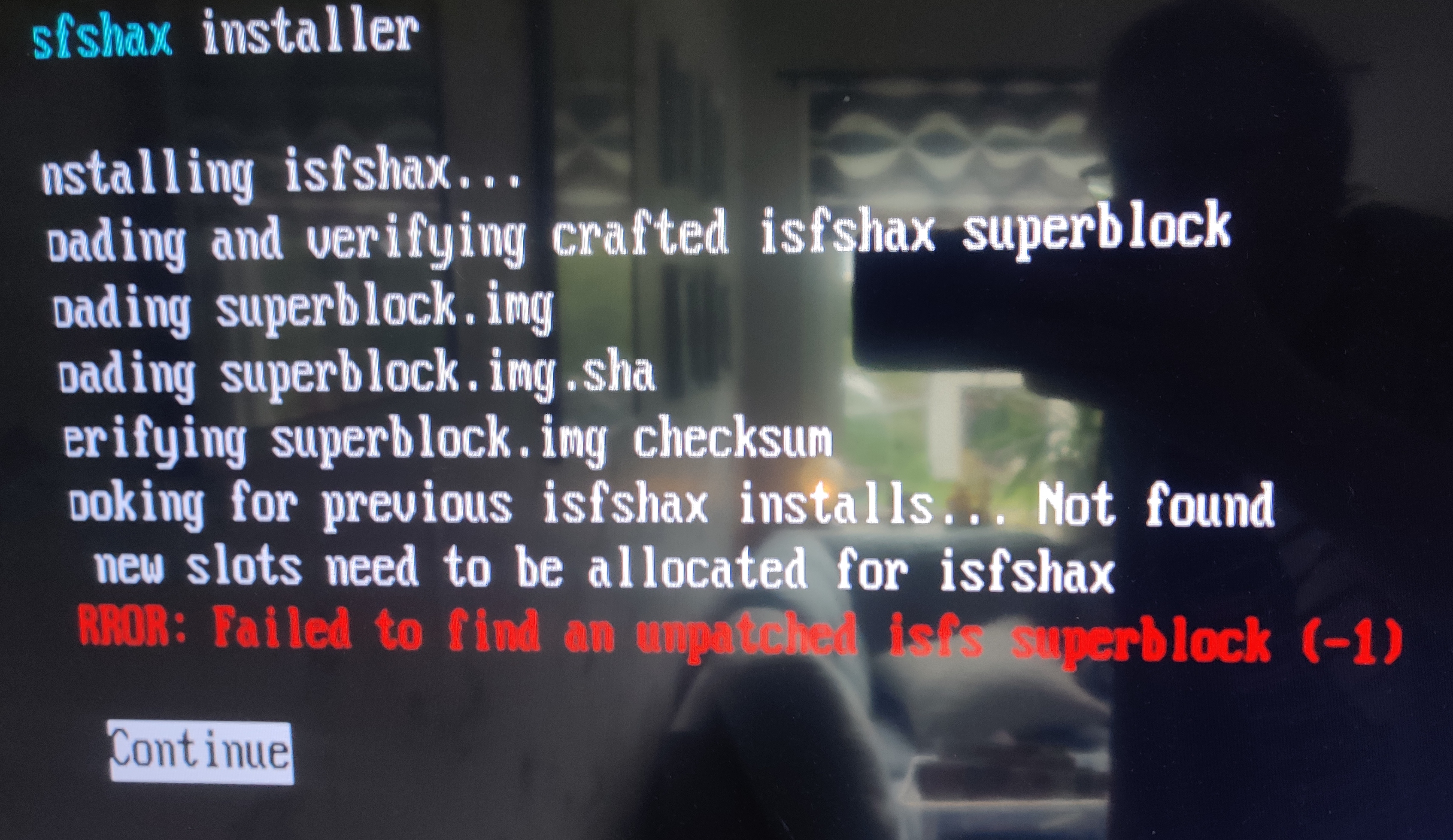

Mine says failed to find unpatched superblocks?

Then your OTP probably doesn't have the correct SLC key. You can test it with the NAND-extractor: https://github.com/koolkdev/wiiu-nandextract/releases/tag/0.1.0
Also all seeproms use the same key. So you could get the seeprom key and the slc boot1 from another console and use that to update the boot1 on your console
the OTP seems to be correct atleast in the NAND extractor. to bad i dont have another console to dump thoose files from...

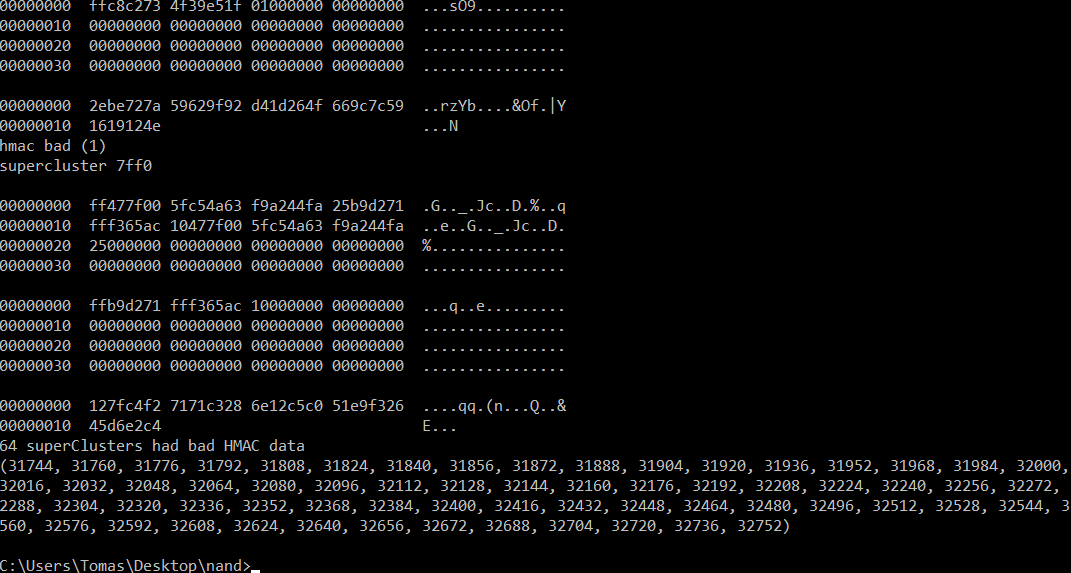

When i check my slc dump in nandbincheck i have 64 bad superblocks.
The superblocks aren't encrypted, only hmaced. I guess the NAND extractor ignores the hmac, but if you extract any file it will likely only contain garbage. You could try with one of the xml files. The nandBinCheck probably complains about the HMAC of the superblocks, right?
Hi i have som pictures of everything so there will be no miss understandings due to english not being my first language :)
I have included the pictures of the errors that ISFShax installer gives me and what nandbincheck tells me.
any ideas how to get any further with this?
The otp i use is a minimal otp created with your python scriprt from my extracted crypto.dmp

yes the problem is tht your otp.bin is bad. You should not try to install ISFShax with that or it will corrupt the SLC.
If you have an older firmware, which the strange boot1 indicates, then the addresses of the kes in the dump might be different, so extracting them probably goes wrong.
So what I would try would be:
1. make SLC and SEEPROM backup and put it in a save place
2. get boot1_slc and otp (for the SLC key) bin from another console.
3. flash the boot1 and let it update the SEEPROM
4. remove the otp.bin
5. try dumping the otp again with PRSHhax
Don't try to to boot or do anything else with the otp from the other console.
