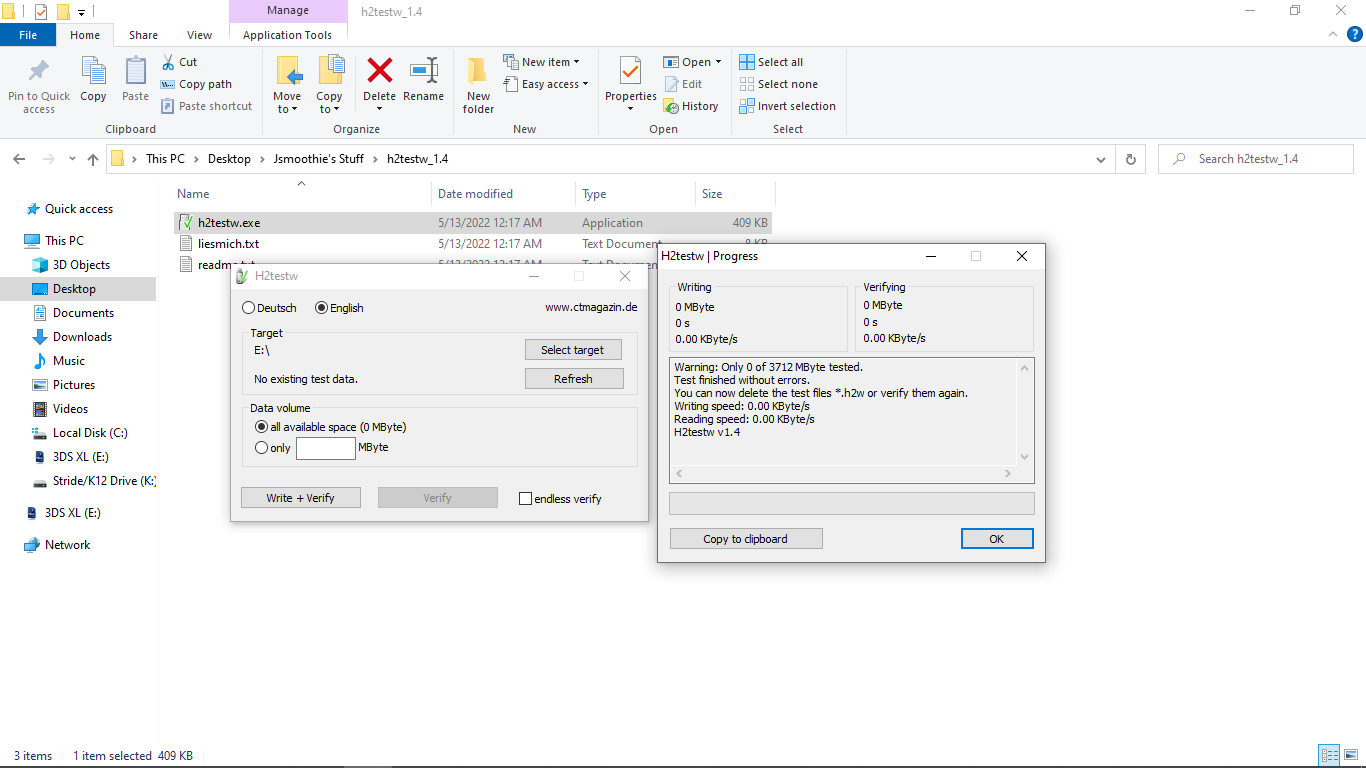

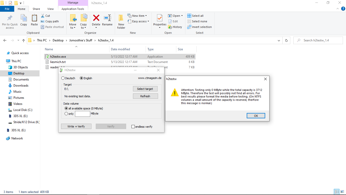

AND I also mentioned that all my blocks were gone and at 0 (which prevented me from testing it with h2testw) so I don't know what that's about.
This is all getting increasingly confusing. h2testw doesn't have anything to do with "blocks".

I see. I moved a 15kb word doc to my sd card and... it worked. (i deleted some different unneeded folders so i could get 500 more kb.)
I meant "MBytes or Bytes"

h2testw is only useful on a completely empty card that has been freshly formatted after everything has been copied off of it. Didn't you read about that in the other threads?
Evidently your card is still functional, at least.
