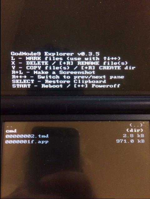

@3dsn00b Please try this:
Download GodMode9 and use Luma3DS's chainloading feature to boot it like you can Decrypt9.
Once you've opened GodMode9, navigate to this folder: CTRNAND:/title/00040138/00000002/content
Tell us what's in there.
This is what I see in GodMode9
Alright, in the cm
Alright, in the cmd folder is the a file called 00000002.CMD ?
If there is, please back out to the main GodMode9 screen and press Y to unlock sysNAND for writing. Then go to CTRNAND:/title/00040138/00000002/content and press X to delete these files:
0000001f.app and 00000002.CMD in the cmd folder. See if it boots now.
OK, but my folder isn't 0000002 it's 20000002... is that normal?
and it's 00000003.cmd
