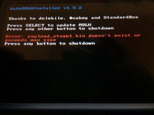

  1. Have tried updating A9LH: No Change. Blank Screen on Boot. Can still access Decrypt9 and AuReiNand Setup Configuration.

Try updating to the latest A9LH with SafeA9LHInstaller.
