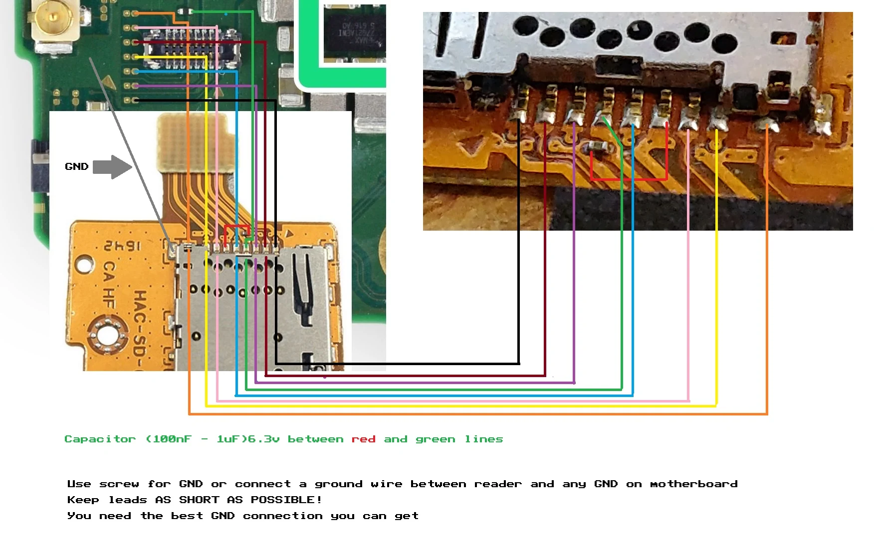

My FPC connector has sns pin missing (orange in the diagram below). I tried with two different sd card readers using the orange trace and making sure there was no short either side but I kept getting an error on the switch about sd card not detected. Please power off and reinsert. Think its a V1 or V2. Any ideas?
Otherwise I will have to ask somebody in the London area to replace the fpc. Any recommendations and how much it costs?
