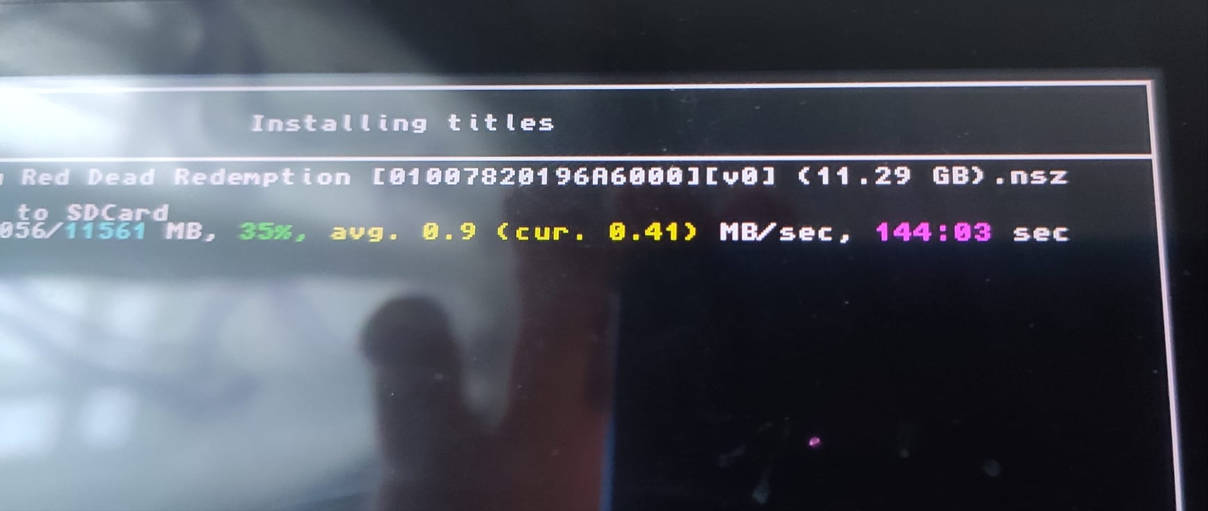

Hi when i try to use DBI or any other usb installer the speed is very slow and take several ours to install a game, previously i never had problem with tinfoil.

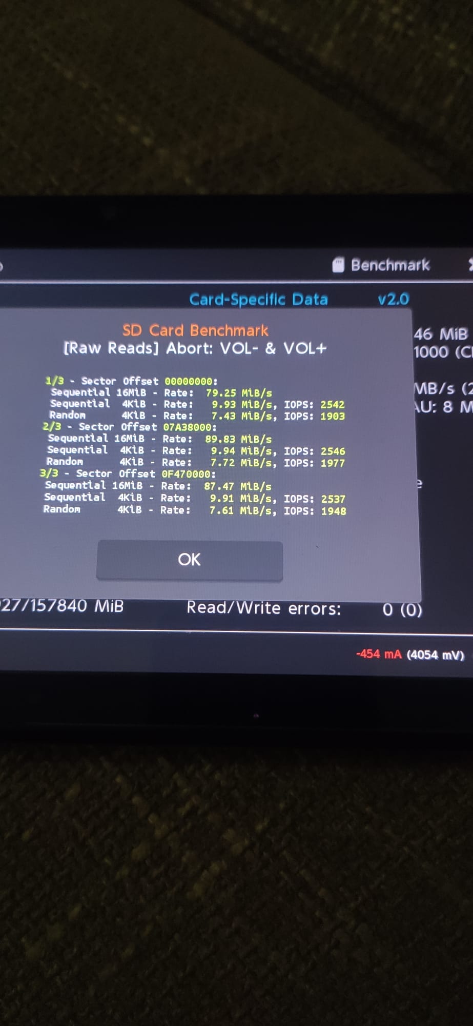

Here my sd bench from hekate, is my sd toasted?

If you have hardly any free space left then the SD card might have a hard time putting the data in the remaining space.
That can seriously affect the write performance.
If you have a lot of free space, just copy some large files to the SD card with a PC.
If that also goes very slow then the card might have some technical issue.
Reactions: gptriple
I had the same problem. My SD card was broken. It is best to check the SD card with H2testw on PC and replace it if necessary.
thanks to everybody, tested td sd on pc and the speed still very low, get new one and everything is ok now
That's actually how I found my Sandisk dying in the 3DS. It was superslow installing a CIA and yeah... moved it to the PC and during that time it even write protected itself. So it was dying.
