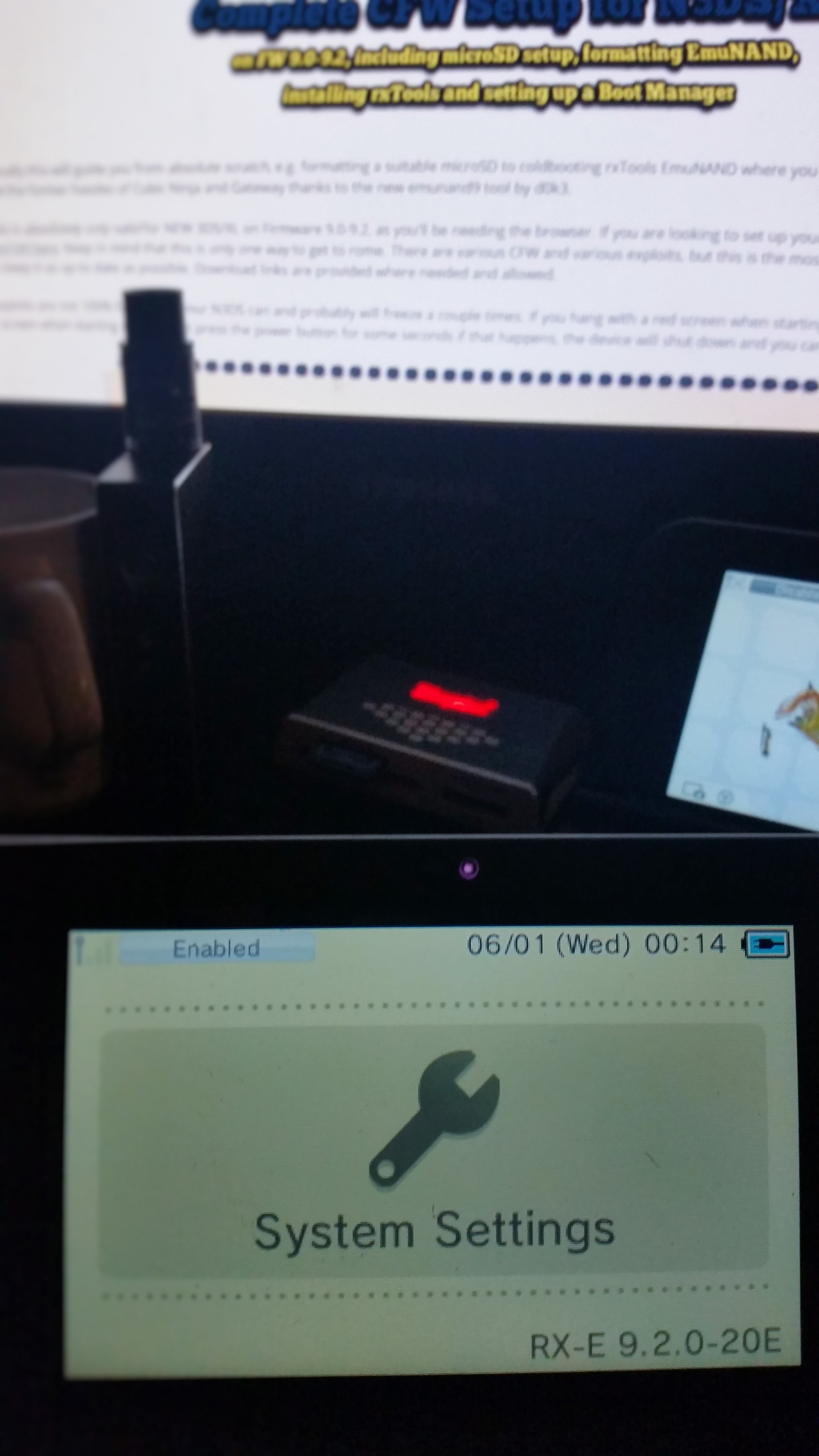

I just downgraded and installed CFW!
Almost brand European N3DS XL 9.4 -> 10.3 -> 9.2 -> RX 9.2
Downgraded using @julian20 's sysUpdater - After maybe an hour or two of constantly trying different things.
Open ftBRONY first, Open CHMM2 first, Wifi ON/OFF, Cartridge in/out, using sysupdate as boot.3dsx etc.
I think in the end it was just a random boot up, open and close either CHMM2 or ftBRONY and then the updater.
For CFW i used @wurstpistole 's [Tutorial] and it went smoothly! (Except for errors on my end ofcourse. I forgot to remove SD card when system formatting while unlinking NANDs:rofl2:)
Congratulations to developers :bow:
I'm almost as excited as i was for the original GameBoy ~19 years ago! (Profile picture)
