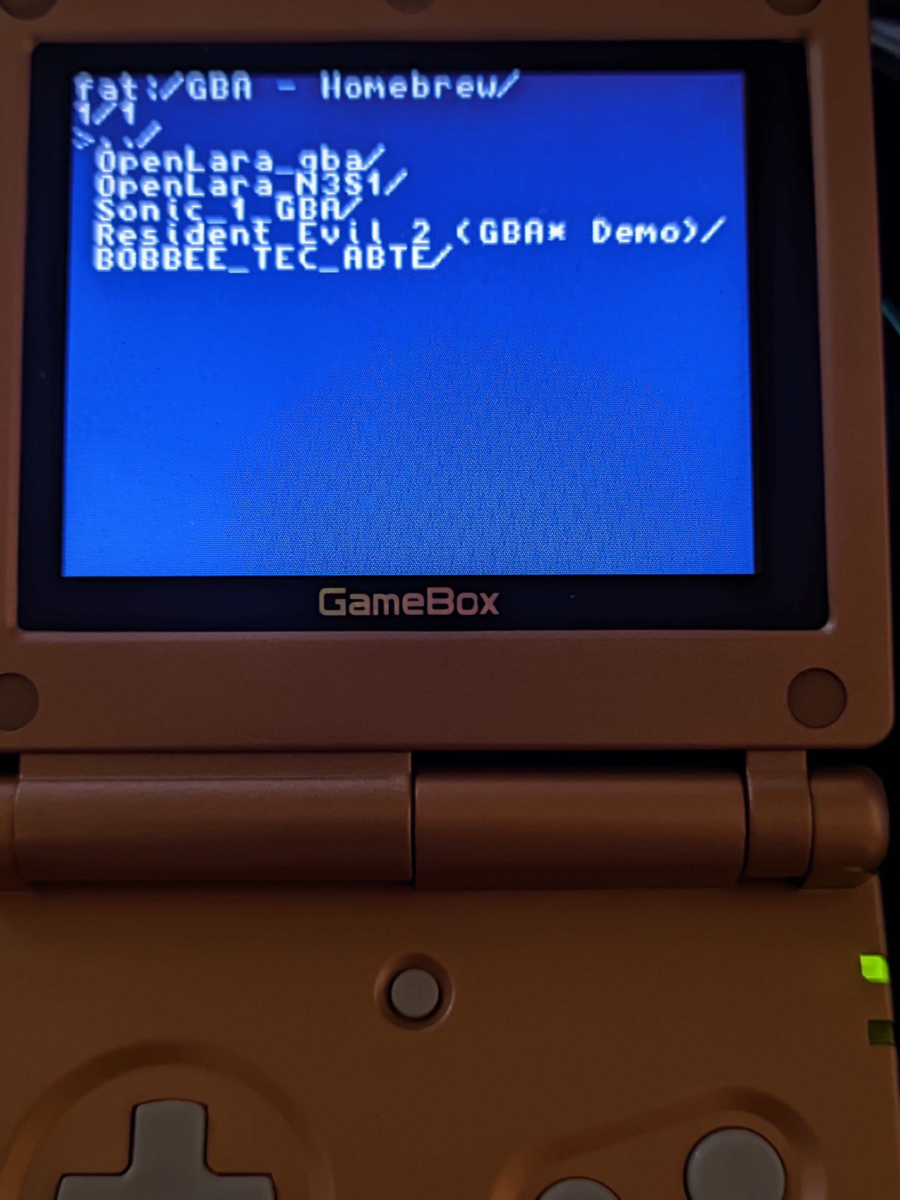

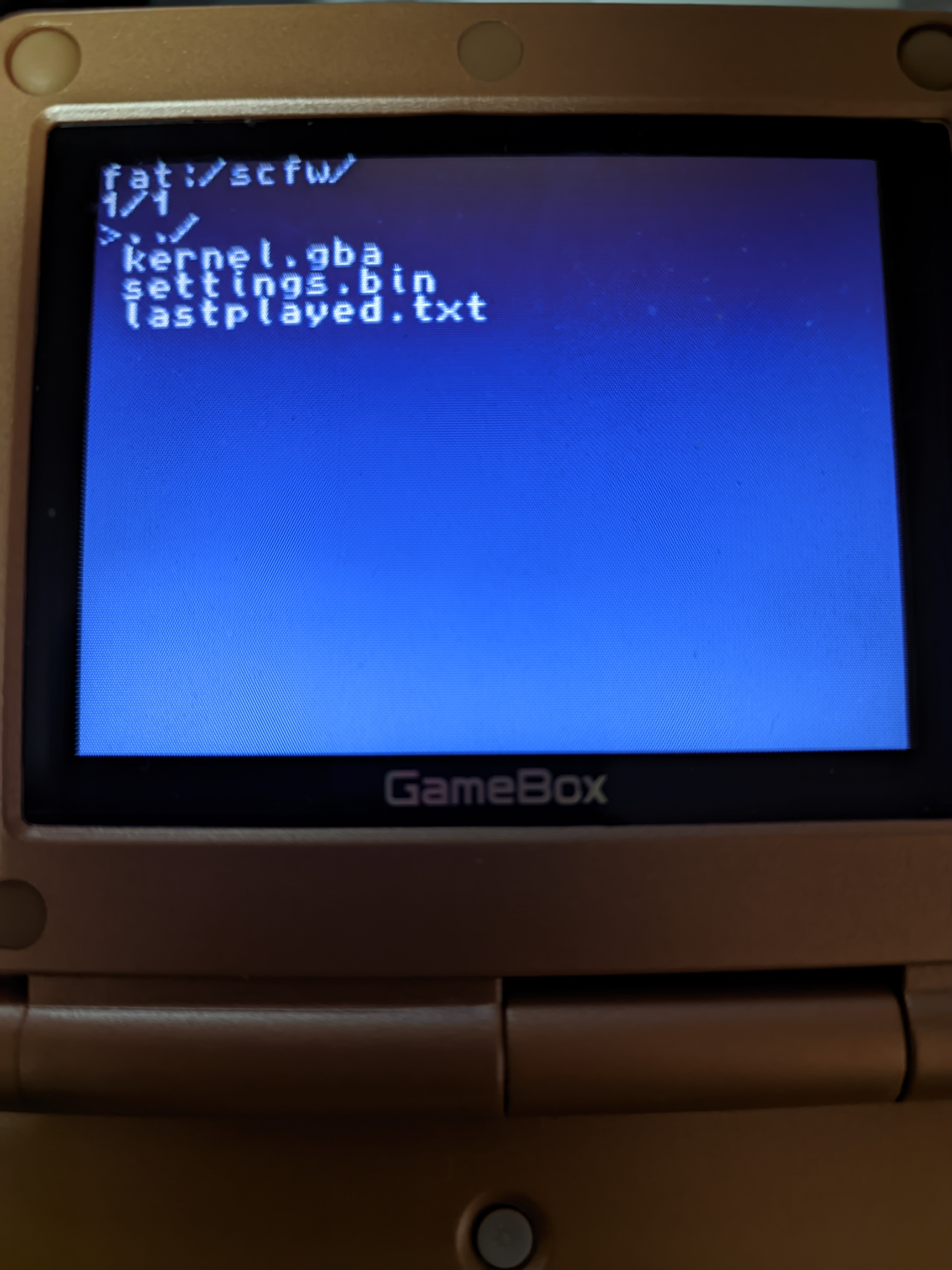

Typically, just copying the sdcard/TF files to another directory/storage medium is in itself a backup already since the firmware's kernel is designed to be plug-n-play.
  • As long as the directory "scfw" is found in the root directory of the card and the kernel.gba file is found inside it, the flashcart will always boot.
You can then just copy that onto another sdcard that's using a FAT32 filesystem.
This is what my sdcard looks like in Windows vs what's shown on my gamebox once inside the flashcart.
EXEQ Gamebox SP:
Windows:
Notice that I removed the firmware file after flashing it on the cart. You only need to flash it once.
