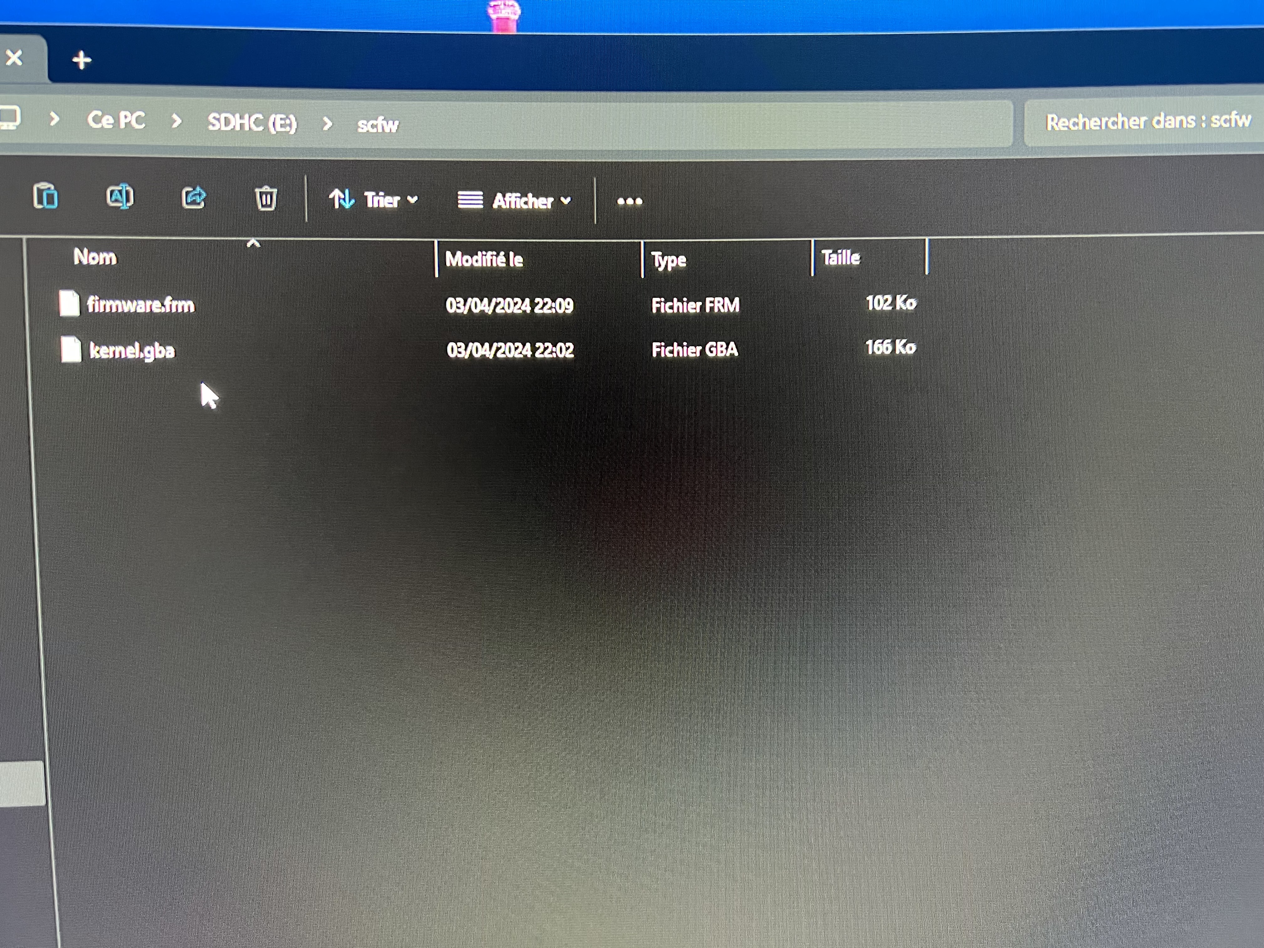

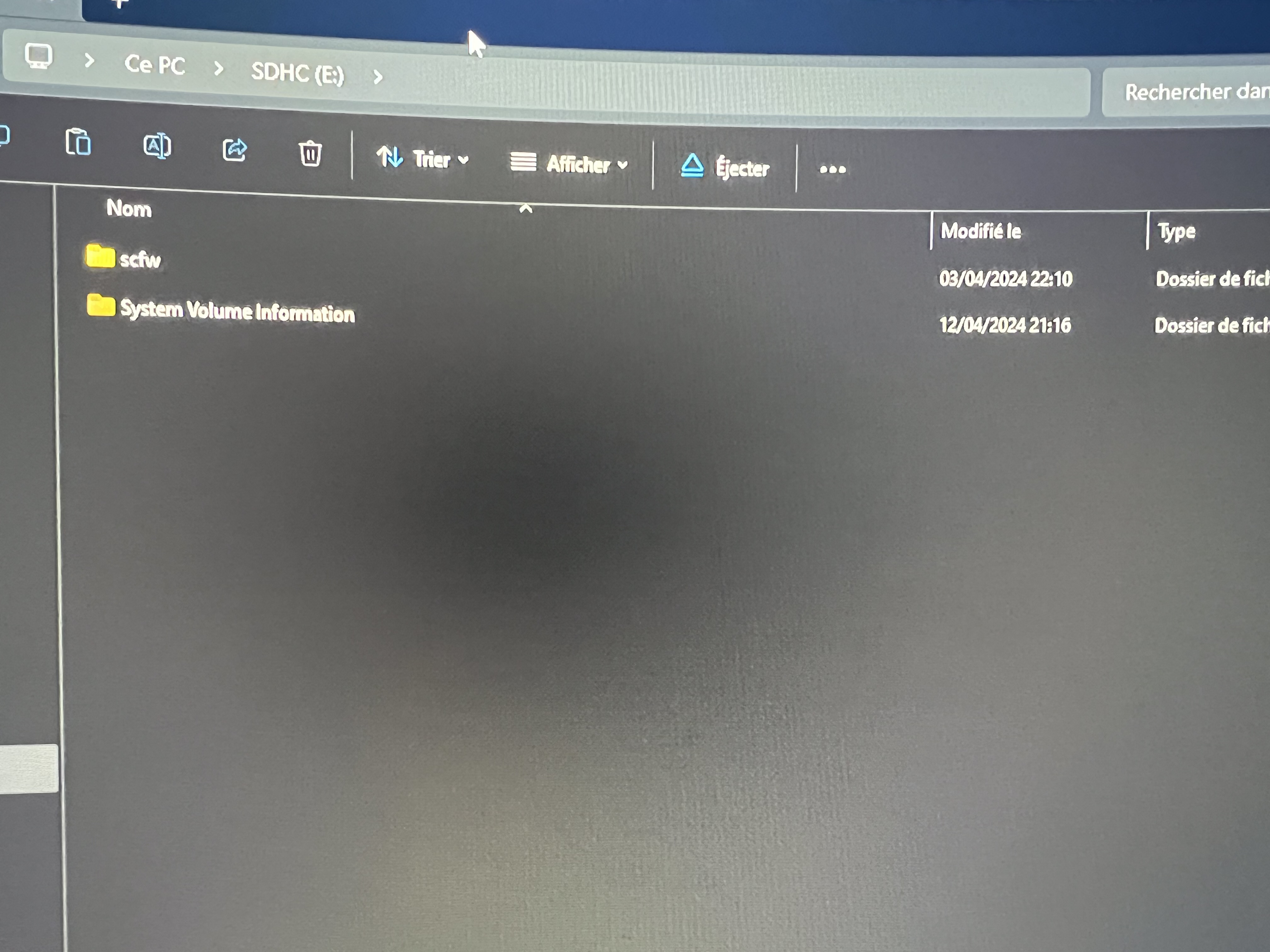

Yes my 4gb card is empty ( just scfw )
Sure
That’s ok ?

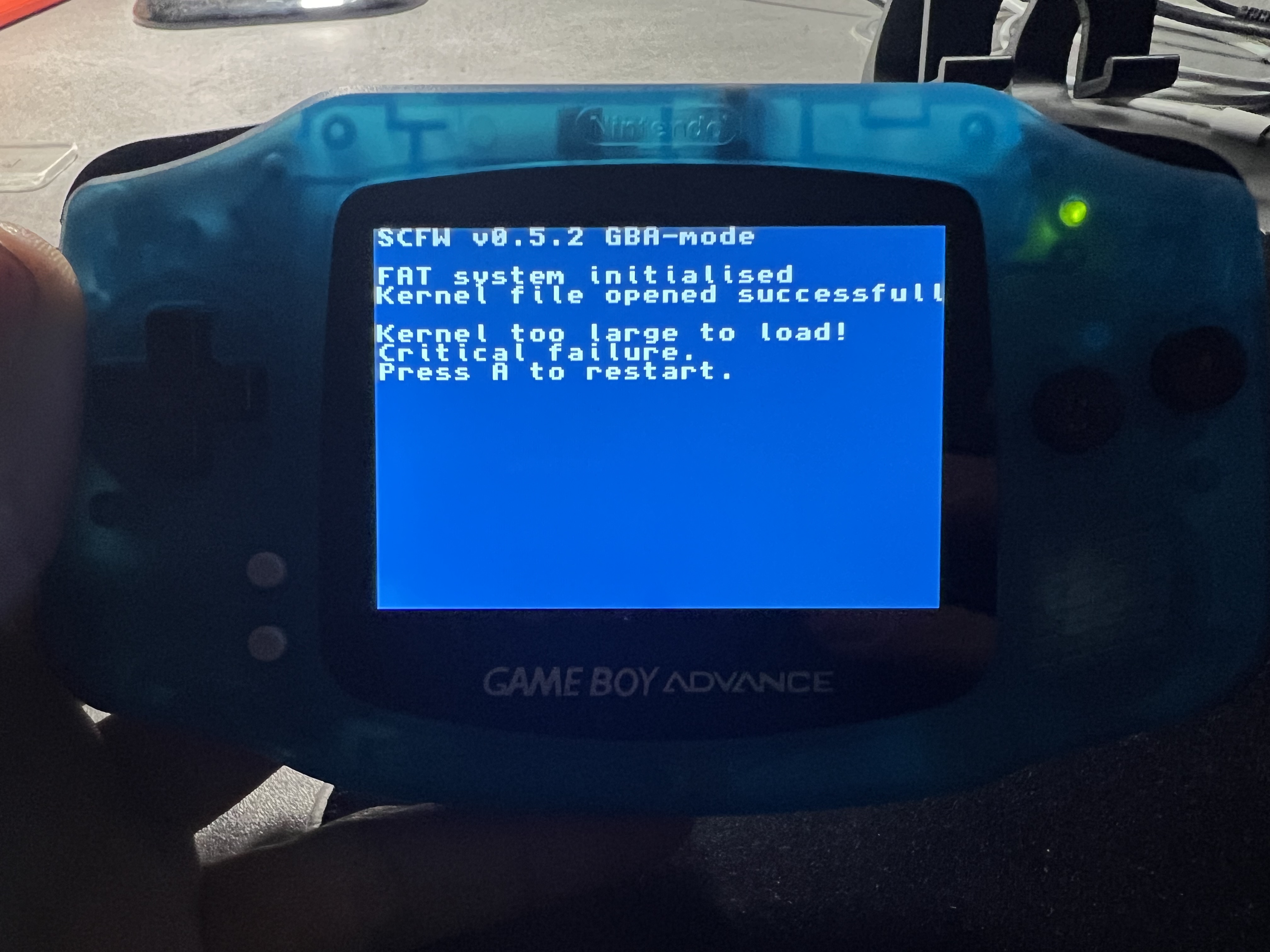

I have put the cf_185.bin on a sd card formatted ( error kernel dont exist) and with the scfw ( same as before kernel too large)
i can't update firmware
Thx for help.
What format is the sdcard? Have you try with another card? And also are you on a DS?
