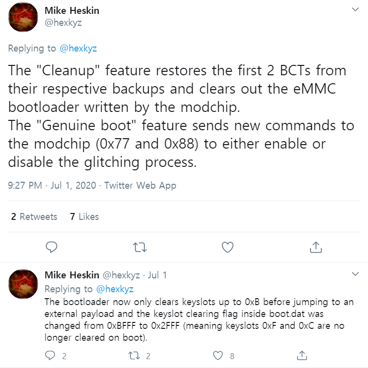

Step 4: Choose Options, click Sx Core, and than cleanup.

Step 9: Delete the existing boot.dat file in the SD and copy over the SX Gear boot.dat and boot.ini.
Step 10: Download the latest sigpatches and copy them.
Step 11: Now you can boot via Launch EmuMMC without the need of CleanUp.
(The new clean up method is from Switchway discord server.)
