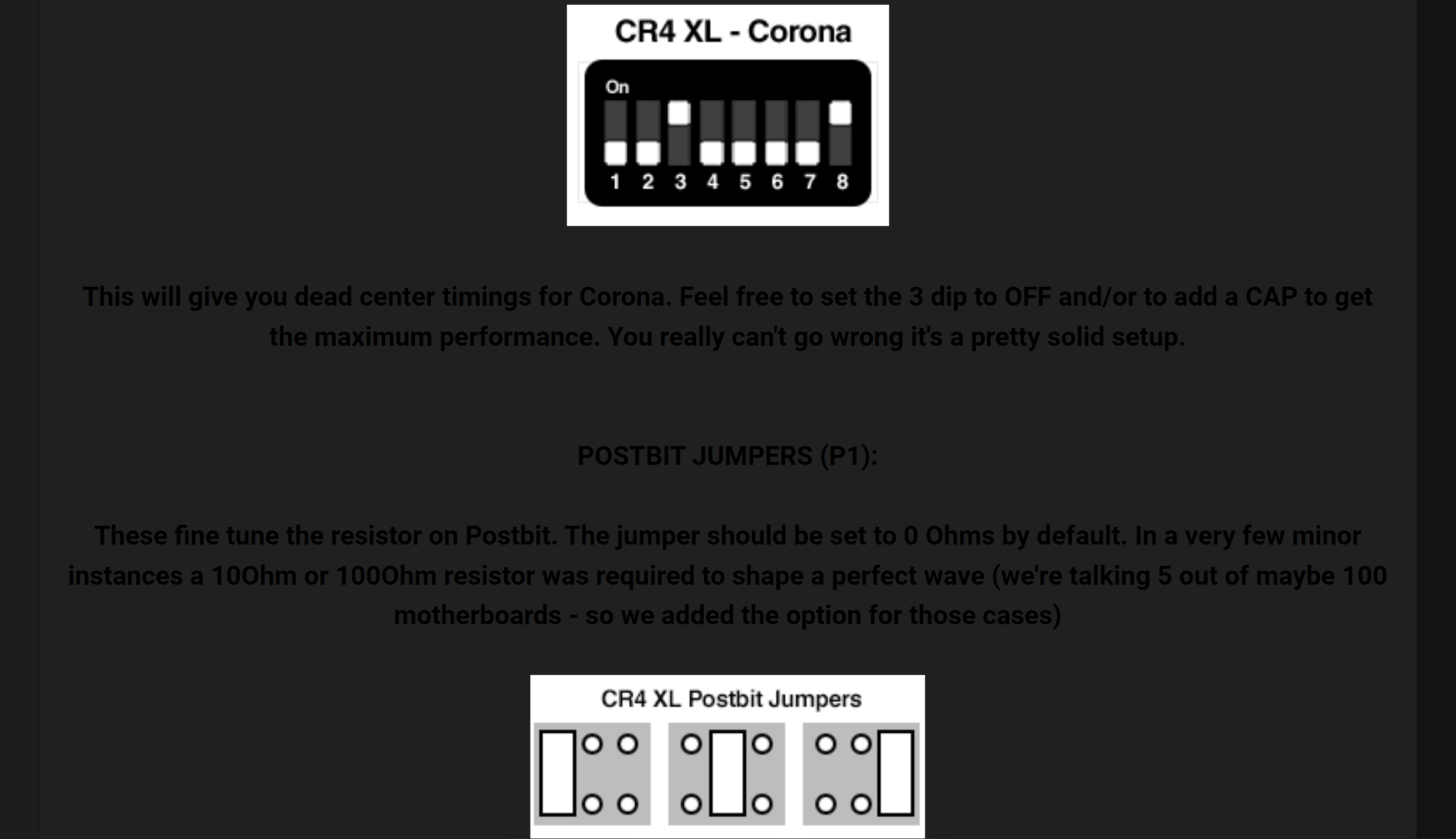

Taken from 7S CR4 install guide. All the dip switches are in the standard spot and the post resistor is set to default 0 ohms which is normal. Since it was booting OK before I would say the added cap is fine. There may be an issue with the last update that was done. In Jrunner there is a box for CR4 installs that includes a sped up reset time of 4 seconds instead of the original 6 seconds, if that isn't checked it can cause issues.
