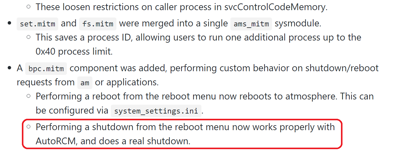

You forgot that Atmosphere added propper Shutdown since 0.8.4. And ALWAYS Shutdown your Console before you remove your SD Card.

It drains battery because your switch enter RCM. With latest Atmosphere you simply shutdown from the reboot menu and it won't enter RCM afterwards. To check if your not in RCM, simply attach your switch to your computer or power adapter. If it turns on normally, it's not in RCM and if it stays black after giving power to your switch, it's in RCM.

Nope. Shutdown from atmosphere will shut it down properly even with autoRCM, so it won't reboot back automatically as it used to.
