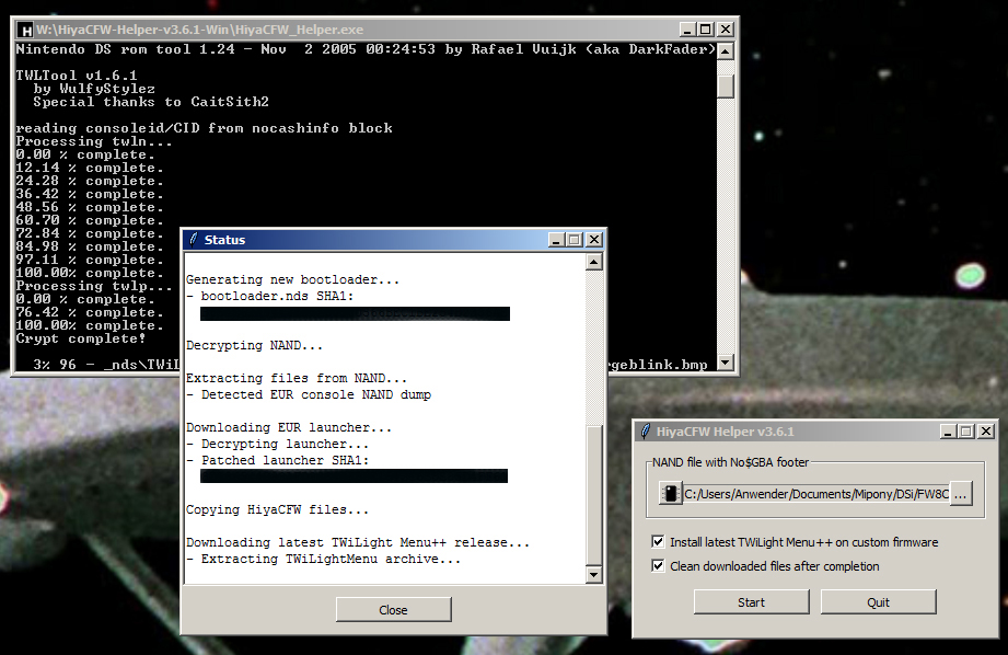

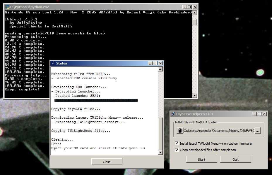

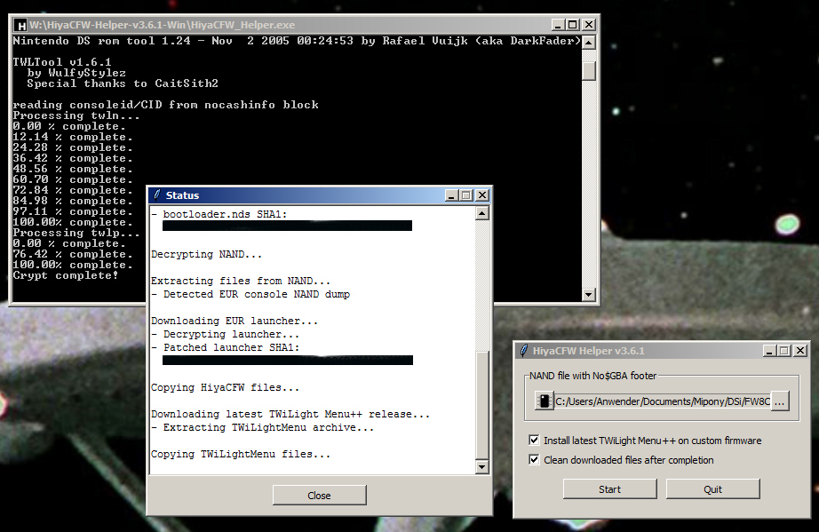

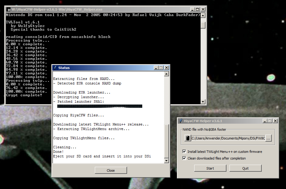

Hello.:)
Did you use the Windows or the Python Helper Version ?
The Windows Version is ok here:
The Python Version works also here:
That can be maybe an Security Issue/Firewall Setting ? Router Setting ? :(
Maybe a little Information on your Internet/Operating System can help us to help you.
Thank you.:)
