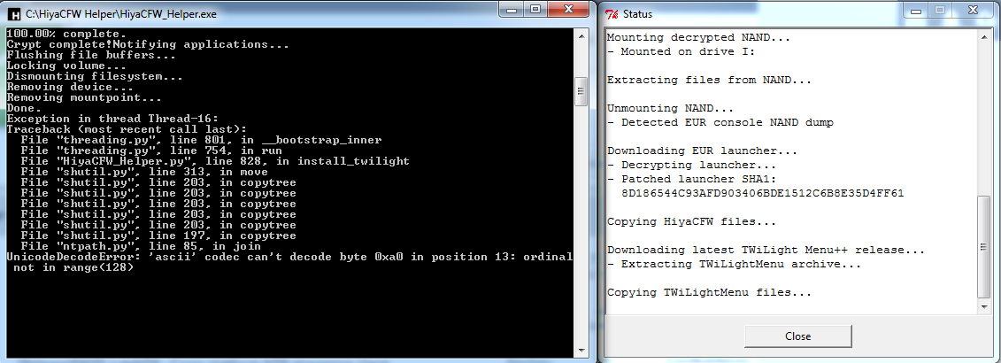

...and I hit another error. An earlier post in this thread had something similar, so I tried moving the helper directory to C:\ and cleaning it from special characters (spaces) but no, still same results.
Problem was with a file in TWiLightMenu that has an unicode character in its name. Please download the latest release that fixes that.

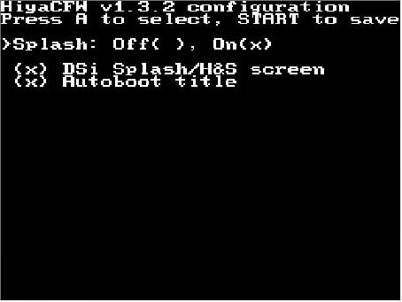

I just formatted my SD card from using an old version of Twilight menu (0.65) and then used a clean nand backup using HiyaCfw helper, yet the Hiyacfw splash on boot is now gone. Is there a way to get that back? As i liked that splash screen
Boot it up to the config by pressing select + the power button
