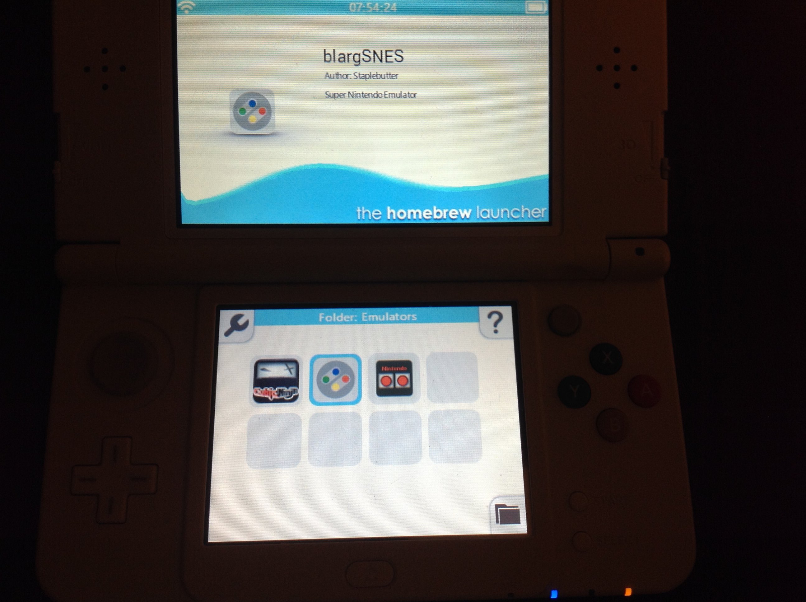

Yesterday was a busy day. I spent hours rewriting the PNG->BIN utility in PHP. The JavaScript version was great, especially with @suloku's updates, but very large images like the font bitmap PNGs the browser would hang or produce a corrupt file. Once my PHP version is a bit more user friendly I will share the source and a link to a hosted version. For now it's functional and seems to be happy to convert files of pretty much any size.
This combined with my FNT to C struct conversion tool has allowed me to get my custom font rendering engine working. As you can see from the attached screenshot, it works! The "blargSNES" text on the top screen is displayed in Roboto, whereas the rest of the text is still in the original ctrulib built in font. Still to do on the font rendering:
  • There are some issues with alignment of certain characters, such as capital S which is a pixel too high (and there are many others). I'm going to try recreating the font using a different TTF conversion tool in case that is what is causing the problem. Otherwise I might have to manually fix the character definitions in the C structs (not ideal...)
  • The font bitmap PNG currently contains all four channels (RGBA). That means the text is drawn in whatever colour it is in the PNG. I need to modify my PNG to BIN conversion script to output only the alpha channel. Then I can simply create a full image in memory using any RGB values plus the alpha values from the BIN file as a transparency mask. Basically this means that the text can be drawn in any colour, and the bin file will be a quarter of the size.
Edit - attached screenshot.

Hey guys,
After spending quite some time manually adjusting the character baselines for my converted fonts, I wasn't entirely happy with the result and realised I would need to repeat the process for every size of every font I wanted to use. I decided to find another way of converting the fonts, and then discovered that PHP can load a TTF font and draw text directly into an image. Not only that, it can also calculate the size of each character in pixels in any given font size. This was exactly what I needed, so I've written a PHP script which allows you to upload a TTF font file, specify the output sizes, and generate the PNG image bin file and the c header and structs to use the font. Best of all, unlike Literra, PHP seems to render the characters in the image with the correct baselines so there is no messing around with y offset values. PHP also seems to render the image data in much higher quality than Littera. I'm extremely happy with the results and will be ready to upload an update with new fonts soon.
The secondary upside of all this is that over the past few days I have devised a complete fonts solution for 3DS homebrew. This solution does not require any extra libraries - it works on plain ctrulib. My web based font converter will take a TTF file and generate all of the files needed to use the font with my custom text drawing functions. All the code is generated automatically - you just drop the files into your project, include the header for the font, and call the drawing function.
The font engine will be released separately once the fronted for the converter is a bit tidier.
