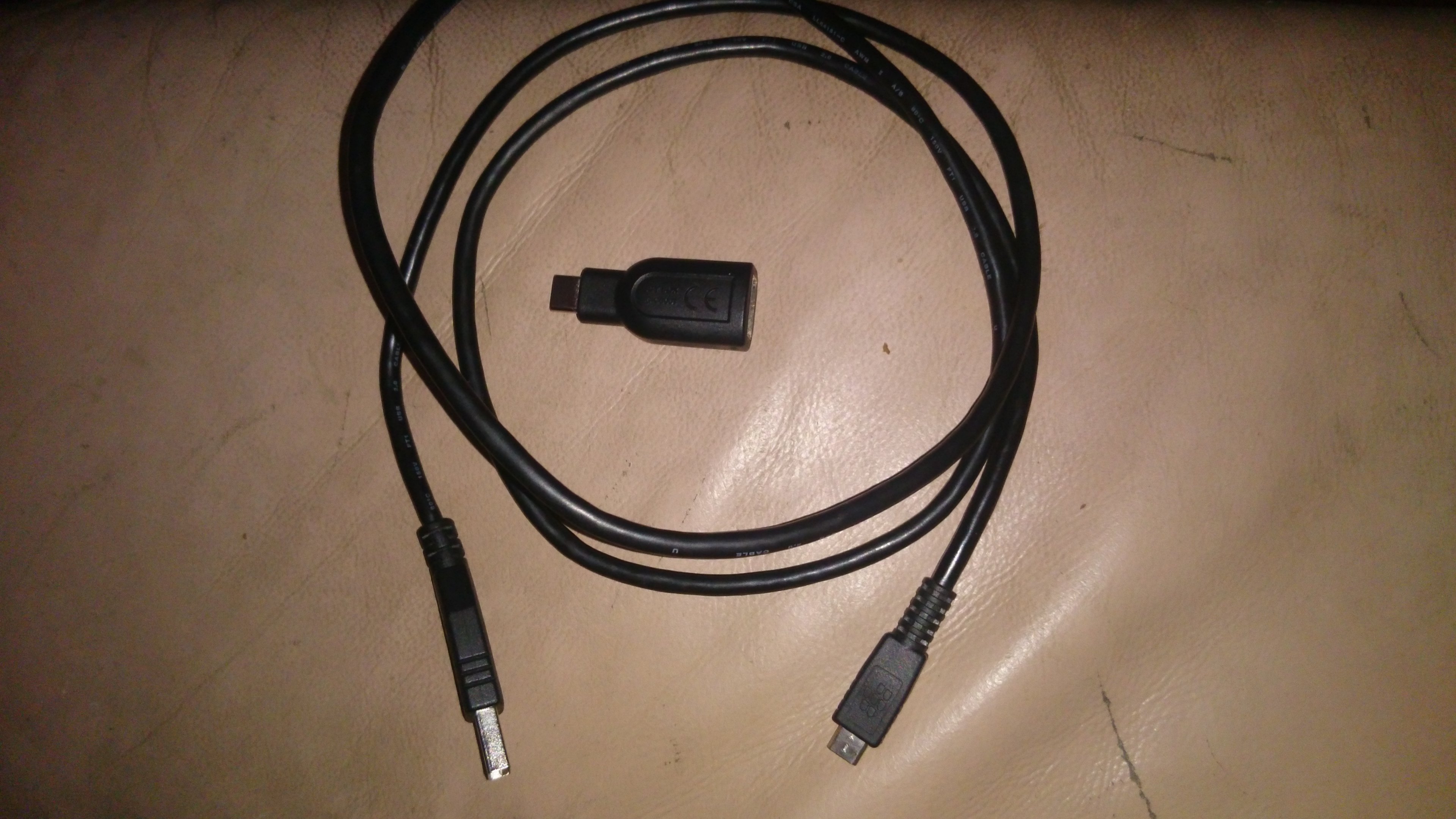

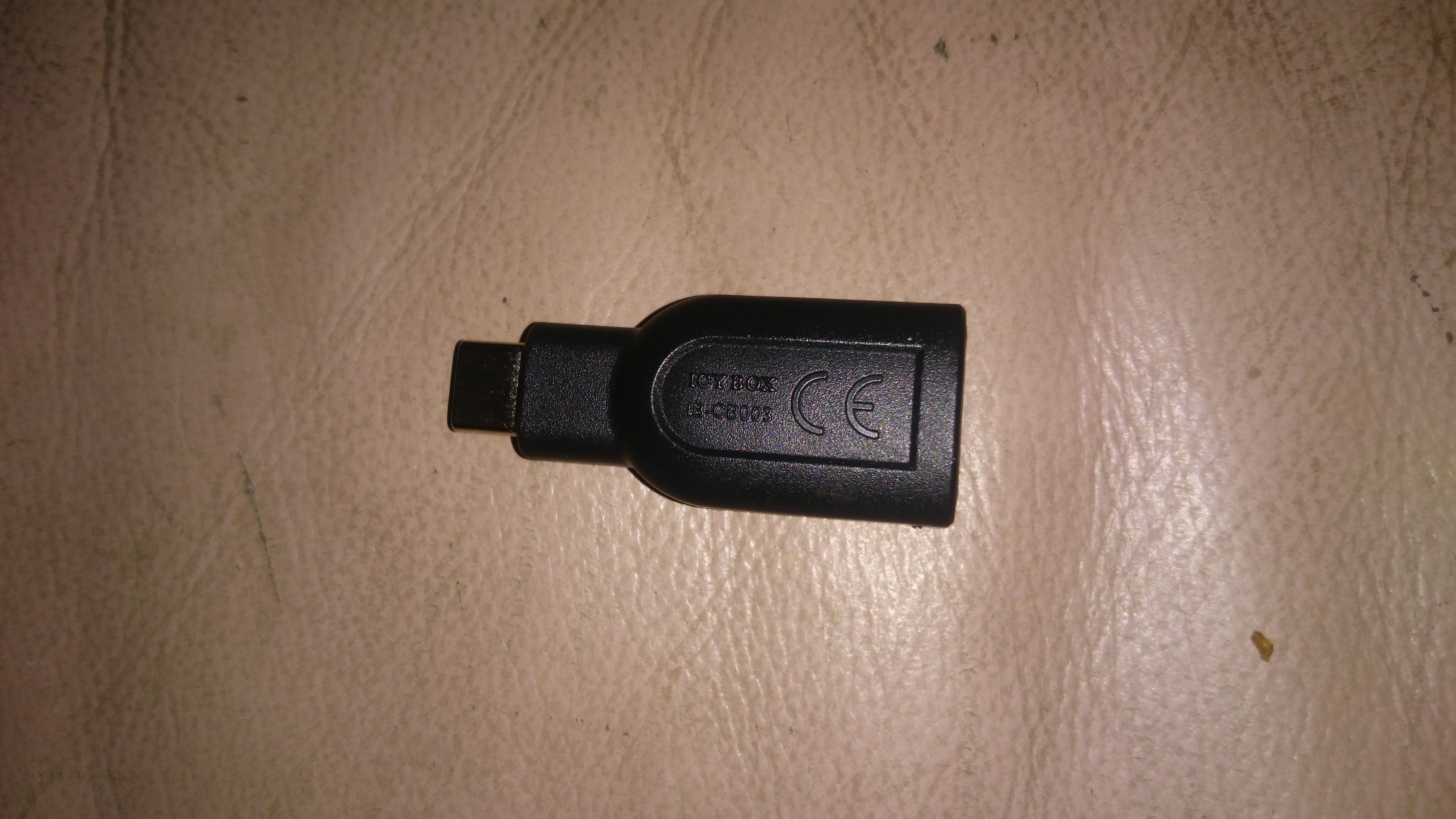

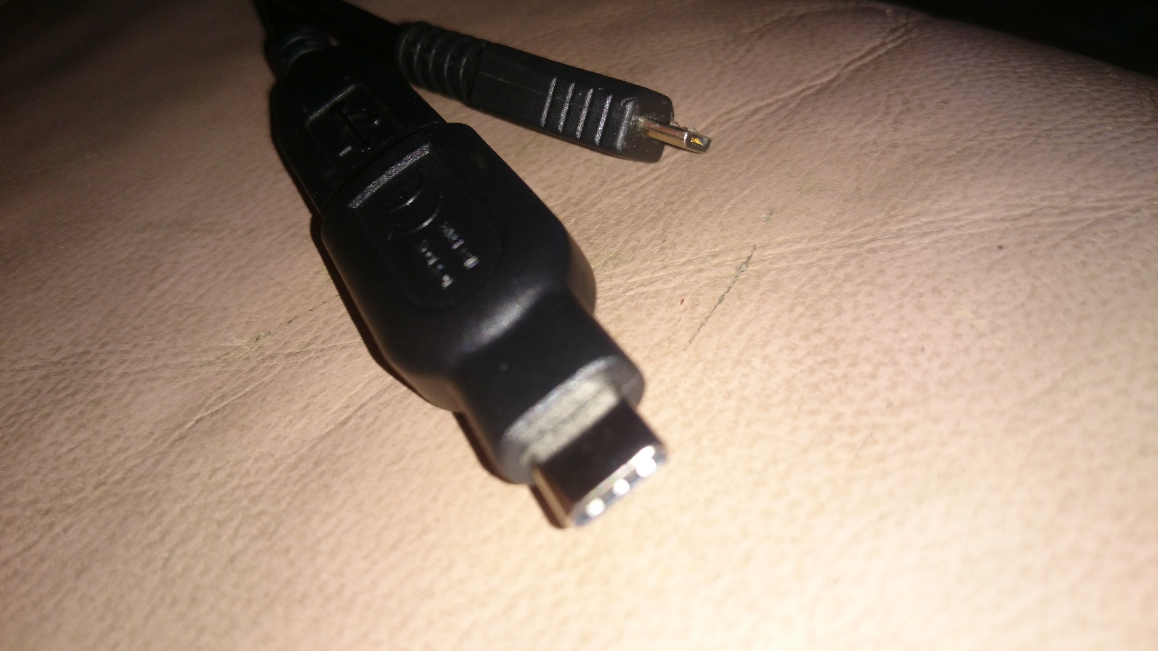

Could anyone help me out?
I'm trying to get it to work with my Sony Xperia Z3 but nothing happens when I try to connect my Switch in RCM Mode to my Smartphone.
I'm using an usb cable with an otg usbc adapter.
And yes, my Smartphone should be supported.
(I usually use this cable fpr data Transmission from pc to smartphone, tried a few others, too)
