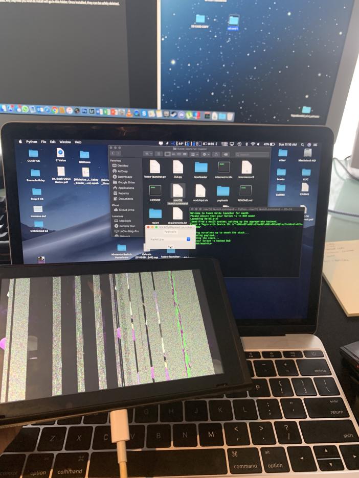

Hello everyone,
I was hoping to seek some help here
I bought a Switch XAW40004 edition (unpatched) running 6.2.0
I've attempted to instal ReiNX 2.0 and followed the guide provided by the official website.
I am using Mac OSX

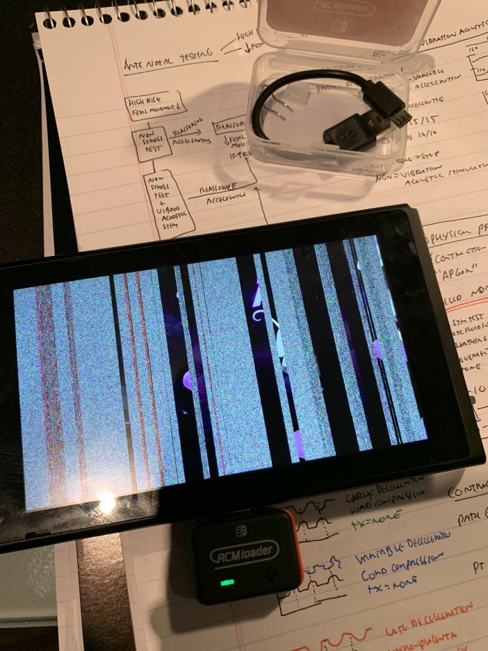

I copied the necessary files from the guide to the dot. had these files verified by other users and I constantly get this glitched ReiNX screen and then it turns off
I've tried using 3 different SD cards and the same issue happens. tried using the files from sdguide and same thing
I've tried using fusee on Mac OSX and also payload injector (portable) and the same issue happens
I also tried gab /how-to-fix-archive-bit-for-all-sd-files-and-folders.515258/ with no luck.
I then tried to use Hekate and was able to backup files. and then tried to instal CFW Kosmos. selected that option and the script runs and then black screen. no Nintendo logo
I repaired the tool > repair sd except Nintendo without an issues
I've tried to format the card via Nintendo Switch, Mac OS disk utility, VM Microsoft using a sdformat.exe file and the stock format
I've tried to use Fat32 and also EXFat and continue to experience these issues
I have no idea what to do next.

Updates:
- restored the device to factory default incase there was a OS bug, still glitchy screen in ReiNX, unable to boot

I formatted the SD using windows. downloaded fresh ReiNX files from the reins.guide website and still have the glitch boot screen.
(I used virtual machine (parallel) Windows 10)
I also did try Fat32 file format and same issue happened
also whenever the screen glitches like in the original post, the screen turns off and I have to wait a few minutes in order for it to boot. holding the power button initially doesn't do anything

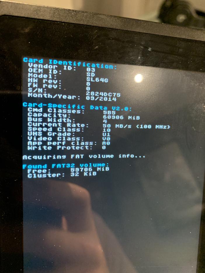

I downloaded the files off of Nevercholt tech tutorial video for atmosphere and received this error message when trying to boot into Hekate and try CFW atmosphere
in hekate if I format using the Nintendo the screen simply flashes "welcome to atmosphere" and turns off. if i format the SD card via windows I get the error message below (3rd pic)
