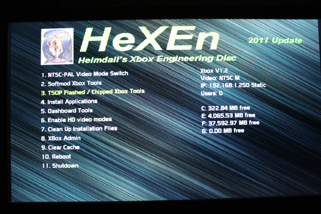

You can also use the 2018er Version,it is about the Flashtool/Program and the Bios(es) included.
It should look like that:
Your Version 1.2 needs the 256kb BIOS Size.
Do not use a 1MB or Bigger ones !!

i just burned ogxbox, i'll burn hexen next, i hear that hexen tends to clutter the drive with a ton of temp files though
Yes,there are other Tools too.That from HeXEn is an easy to use one.
For myself I have always used the Flash Tool which was in the (Linux ?) Loader from Chimp included (GenX Tool or so,I do not remember...)
EDIT - Gentoox Loader - thats it,there is an Flashtool included,I always used that one.:)
