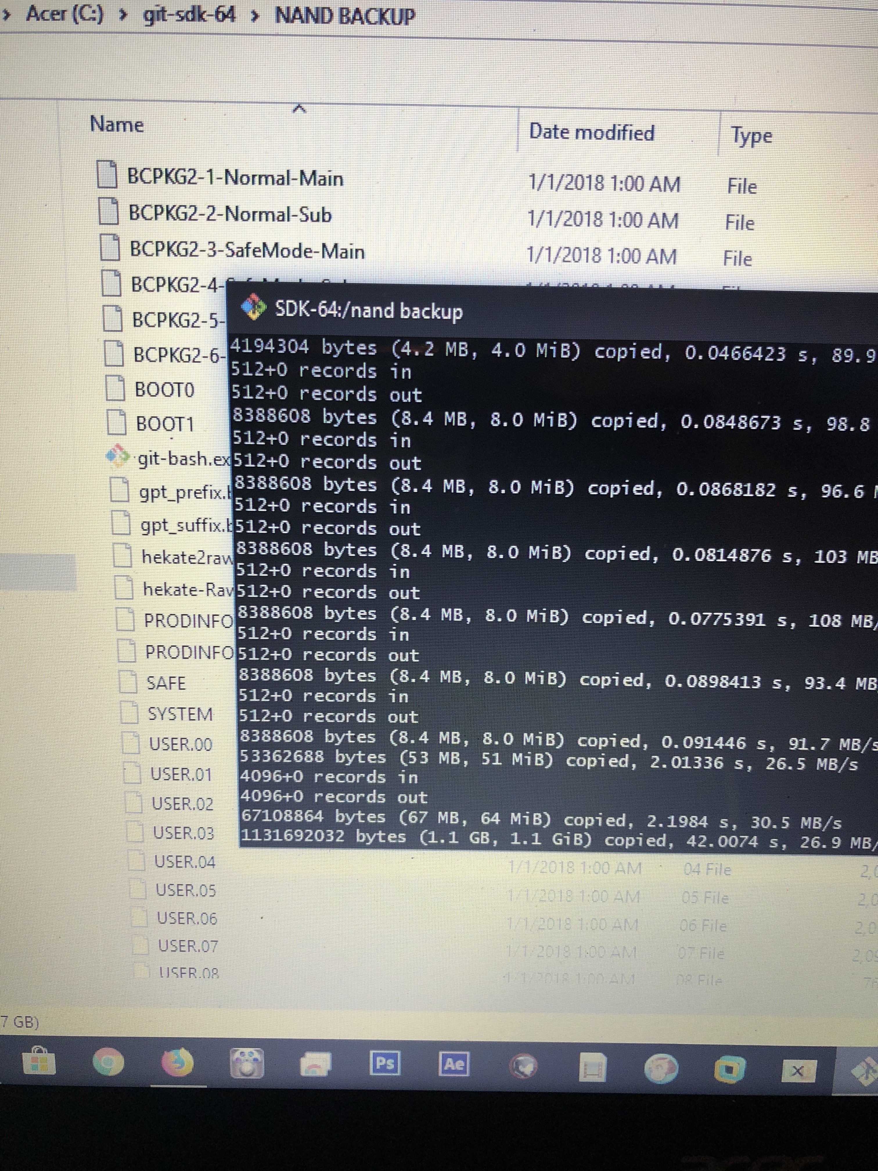

You need to use this https://pastebin.com/vdCqxrci, to merge the dump to a RAWNAND Backup
When I try to run that in Ubuntu it tells me that the command is not found, even though I am 100% sure I am in the right directory and I have the files from the hekate2rawnand.zip file
EDIT: I had to run it through DOS2Unix
Yay making one massive file now
