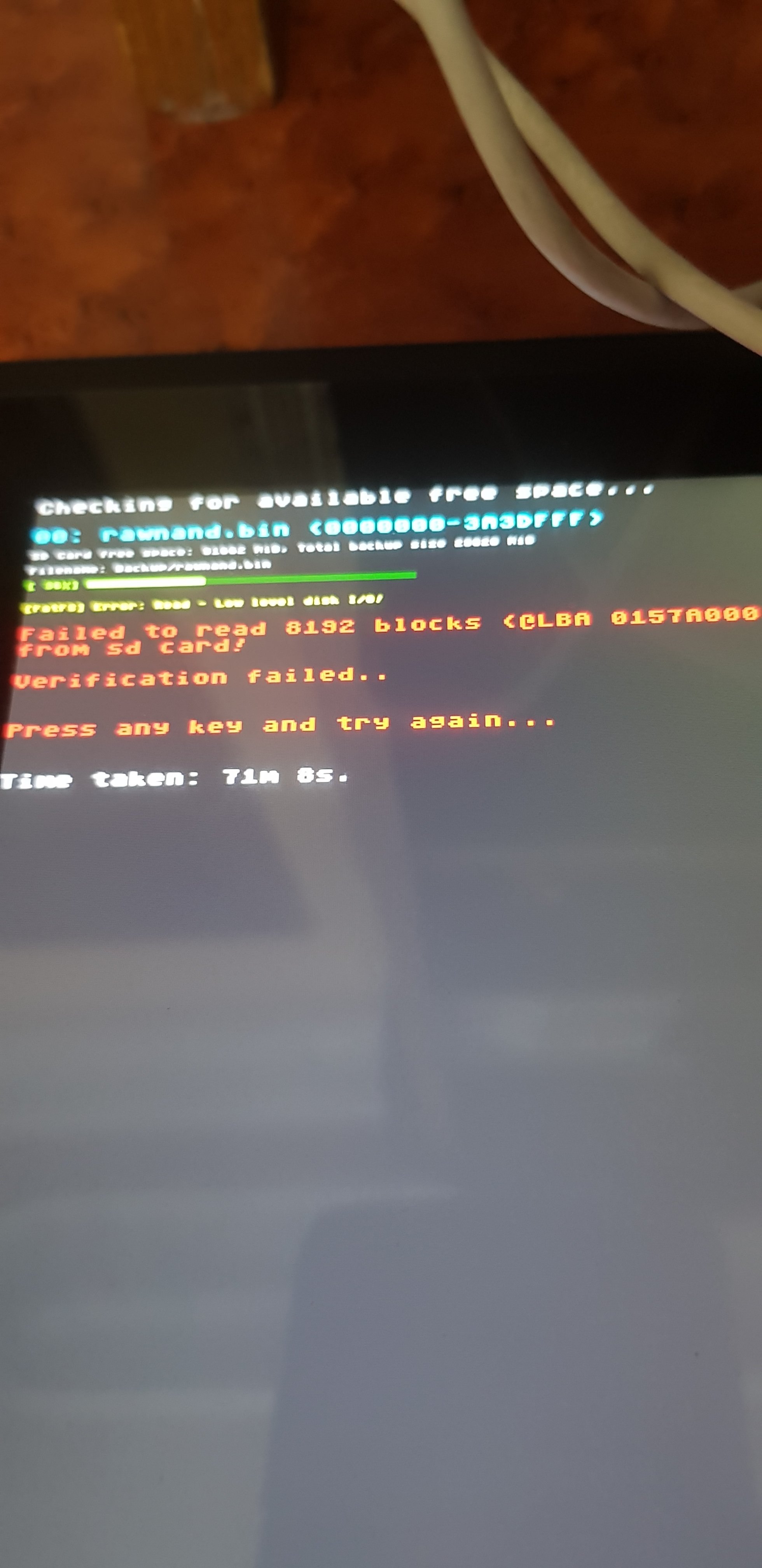

verification failed full backup
My most recent backup attempt with info
Single file, failed 52%, failed read from SD @LBA 01EA6000
Trying again now
Trying again now
failed again
Single file
52%
[FatFS] Error: Read - Low level disk I/O!
Failed to read 8192 blocks (@LBA 01E9E000), from sd card!
71m 18s
