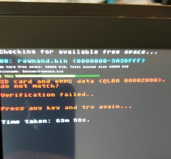

I'm getting the same thing... payload 3.0 and Rocket Man 5.0 files, Full NAND backup completes successfully but eventually it fails in verification.
Tried it a few times with a few different cards too. Anyone else getting this?
