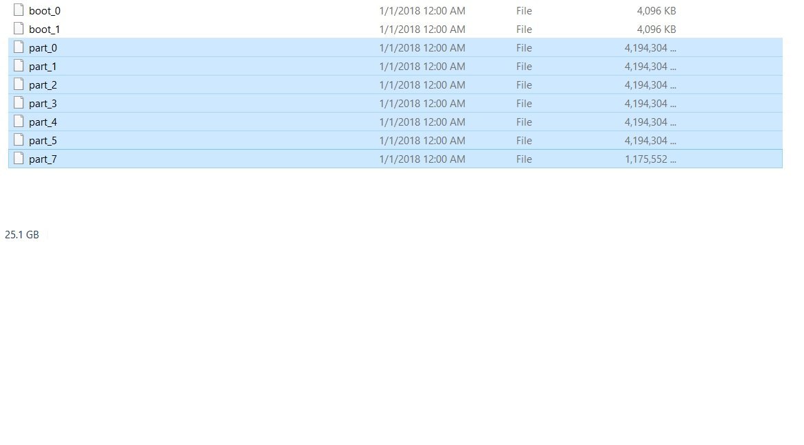

I have dumped the nand several times but part 6 is always skipped... I use a 32 gb sd and I dump all parts until part 6 hat I have to copy all contents of the sd to my pc and then boot again hetake to finish part 6 and 7 but 6 is always skipped. Anyone knows the reason?

Thanx!!! as you can see in the picture, Im always missing part 6 when dumping.

Actually as first post says : Join them by using "copy /b part_0 + part_1 + part_2 + part_3 + part_4 + part_5 + part_6 + part_7 rawnand.bin" = 32gb (8 x 4gig files)
Also at github : The USER dumping is done in 4 8GB parts (splitted in 4GB files, max for FAT32).

I have the same problem: Part 6 is always skipped.
I tried a 32GB SD and a 64GB SD Card. Part 1-5 and Part 7 works.

  • Any user that has a 32GB (at least 31,500 MBytes available. It can barely fit it :) ) should use the latest hekate commit. rajkosto upstreamed all his changes there.
  • For any user, with smaller than 31,500MB sd cards, I'll release a special version based on the latest commits that lets you choose manually the parts to dump. Probably today.

v1.1 released.
Thanks to @rajkosto it is now working better and correctly with no hacks and hard coding. It can even support, future Switches with bigger eMMC.
