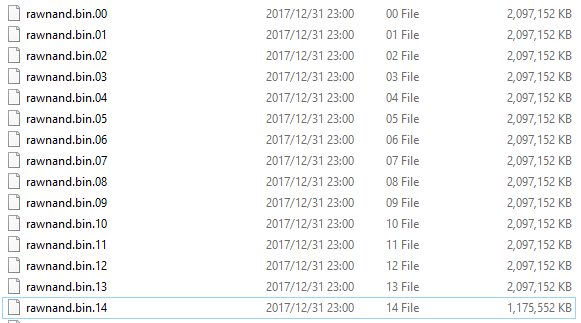

Got to 91% this time. It didn't write a partial.idx this time though and attempted to restart from 0%. When I ran the 1.3 version it did create a partial though I deleted it before trying your 1.5 beta. So I'm going to try 1.3 until it errors then continue with 1.5 I guess since I know it can recognize the partial. It just does not like something in part 13 at all.
Edit: Unbelievably this finally worked. I feel like it must time out at some point which caused the error for me at 90%ish. Let me know if this looks right
4K8eu4l2
Yes they look correct in size. Check the forum for the total size in bytes. It ends in 320.

Hello, here is the pic of my dump. I got 13 part : Switch 5.0.2
Is that correct ?

Might being missing 2 parts? Idk, what size is your sd card?

Ok, I repeat the dump now !
Is that correct ?
You've done the wrong procedure. You selected "Dump raw eMMC" on the first session, and when you moved the rawnand.bin.XX files, you pressed "Dump eMMC USER".
It's either raw->raw or user->user, until it's finished. Not mixed.
