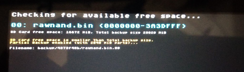

Is this... normal?
It's been on that for a while now.
Yes. The partial backup is enabled because you have 16GB free space.
After this round is finished, you follow the steps it shows.
Shouldn't it show a progress bar? It's been on that screen with nothing else going on for a while.
It should, but not right away.
It tries to allocate clusters for that size, 2GB for your case and then starts.
If the sd card is quite fragmented, it can take more time.
How big is your sd? Also what cluster size it has?
hmm 16KB cluster is a no.
It's better to backup your sd card.
Reformat with 32KB cluster.
Restore stuff back and run the 2 archive fixes to restore/unset archive bit where it needs to.
Roger that, will do. Thanks for replying so quickly!
edit: formatted as exFAT, 32KB, I have a progress bar now
