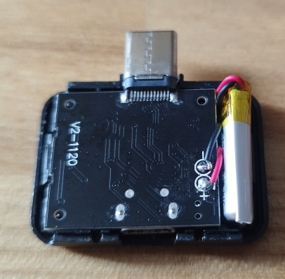

Is battery replacement for the RCM Loader as easy as plug and play or do I need to solder?
You'll need to solder it in. I'm absolutely crap at soldering and managed it as its only 2 wires.
Note that the replacement battery may be slightly larger than the old one and you'll need to tape the outside case together as it won't fit in the case properly.
Reactions: mr_switch
I figured I would update this for some people since I am dealing with this now
and you need the 45mah not the 50mah will be thicker
Ebay Battery goes for almost $8 you are better off just ordering a new one from Ali since those go for now $9/10
These are the 2 solder points

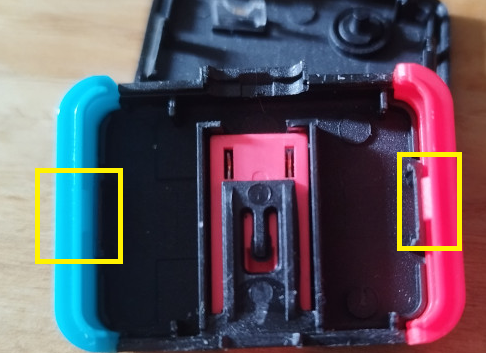

Use a pry tool
