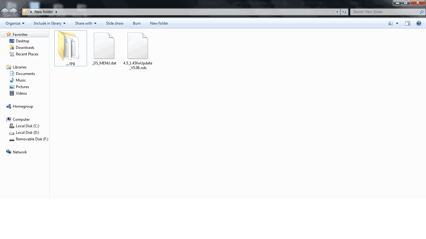

    Screenshot what the files look like on the MicroSD?

    Here you go!

    Oh My God!!! I actually solved the issue!!!
    Here's the solution as future reference if anyone else has the same issue:
    1. Copy the files in the screenshot above to the root of your SD (You can get them here: http://www.r4i-gold.com/en/download/skin/2012/0115/281.html, just in case ;))
    2. Load the flashcard onto a DS (phat) or DS Lite
    3. Once on the flashcard's menu on your DS, select the 4.5_1.45fwUpdate_V5.06.nds
    4. It will ask you if it's OK to upgrade the firmware, if ou agree press the A button.
    5. The update will start, it will take about 3 minutes.
    6. Afterwards you will have to power-off the DS.
    7. Your flashcard is ready! :toot: You can enjoy it on your DS/DSLite/3DS! :nds:
    Note: My 3DS is of firmware 4.2.0-9E, I don't know if this flashcard will work or not on higher 3DS firmwares.
    Wow! I'm so relieved! Nothing beats this feeling of satisfaction! :yaynds: Thank you guys for your concern and replies.
