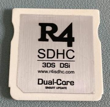

So I bought a second hand 3ds, in it was a working r4 clone (came free with it) and I also got a non working r4sdhc-3ds-dsi-dualcore with it for free! It was a great deal btw.
I confirmed it non working (after trying countless woods, ys menus and so on).

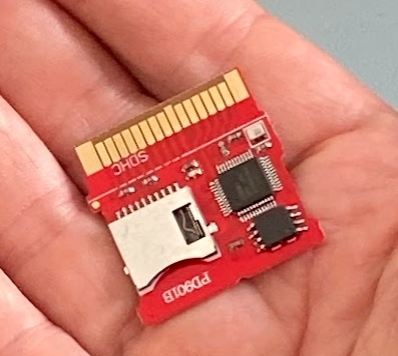

Now I opened it up and looked at the connections on the pcb...

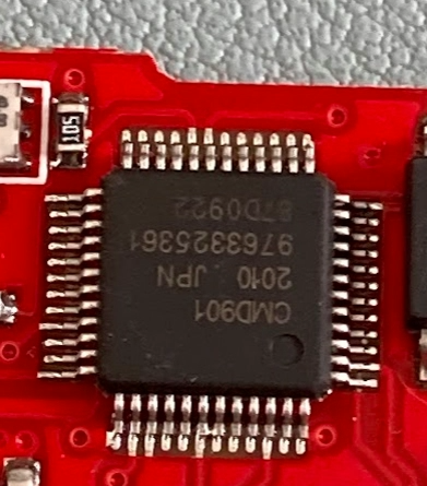

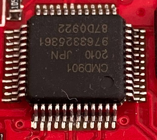

It looked liked the 6th and the 7th pin are bridged, pulled my multimeter and yes: bridged.
Now the question: should I get a hobbyknife and try cut/pry to unbridge it or put on some flux and apply some heat (problem is my iron is way to big for this small stuff)...
Suggestions?
You might want to open another thread in the NDS section, where flashcarts are usually discussed.
For my part, I would advise you to use a knife with a thin, precision blade to separate those two pins, acting very gently and with accuracy.
Edit: Then when you will try it, don't use random firmwares anymore, just the right one! Otherwise you will permanently brick it for real.
Tried the knife route: successfully unbridged it :)
