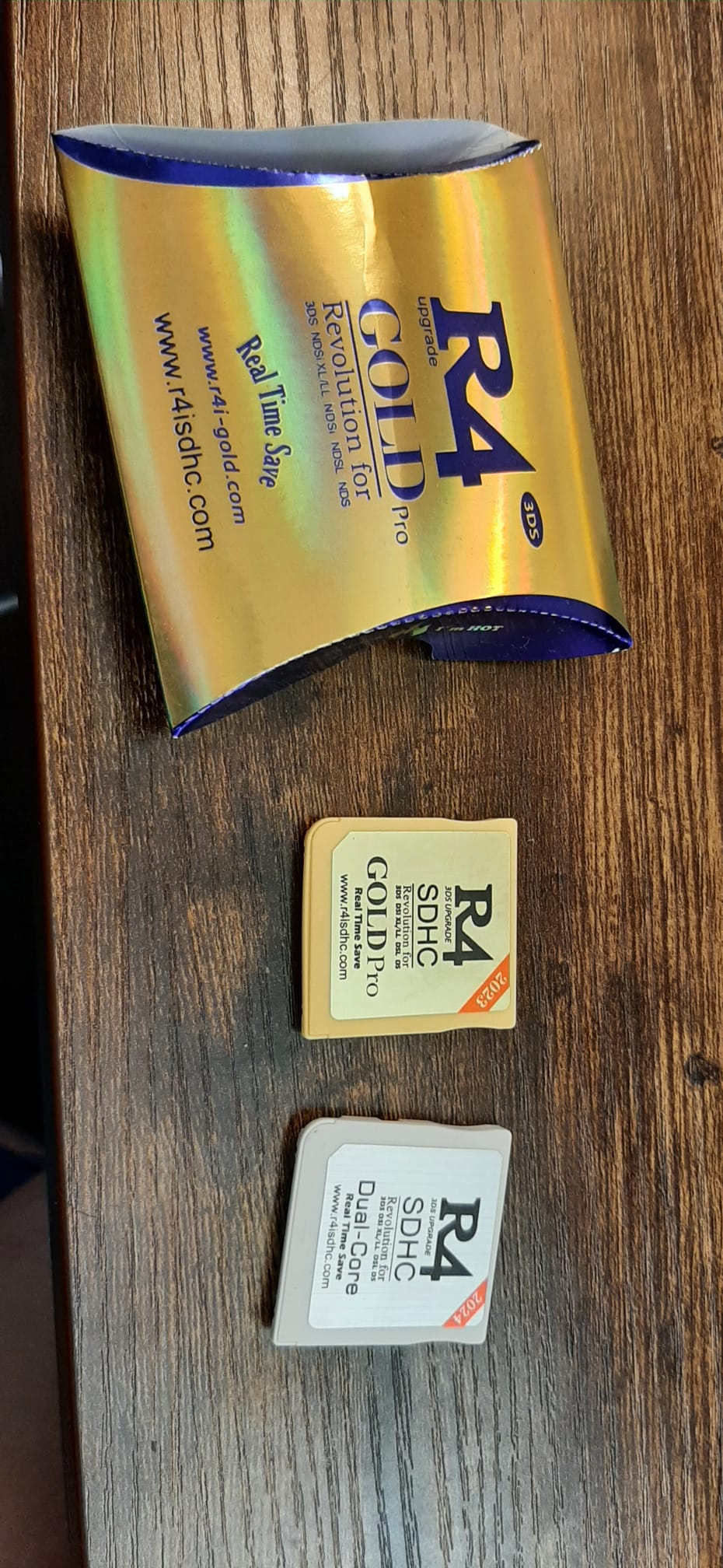

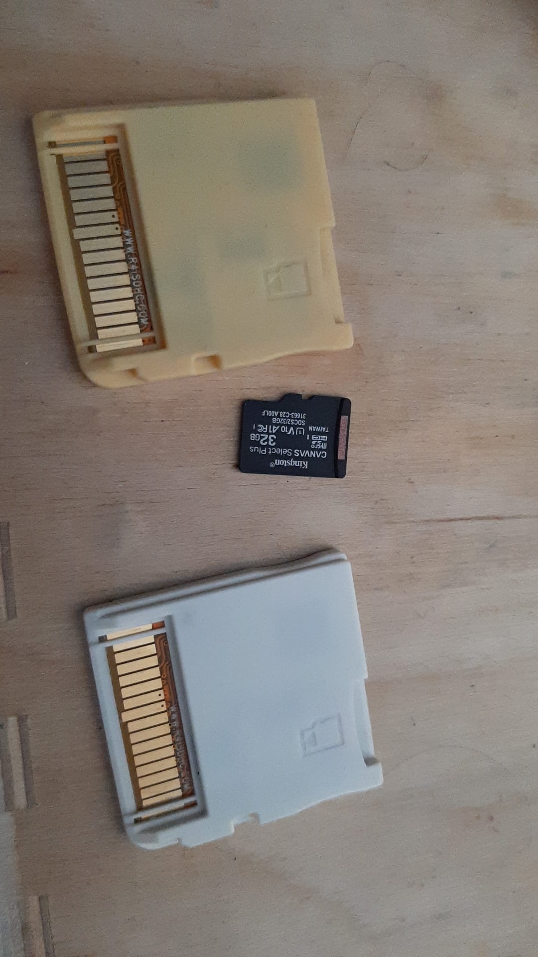

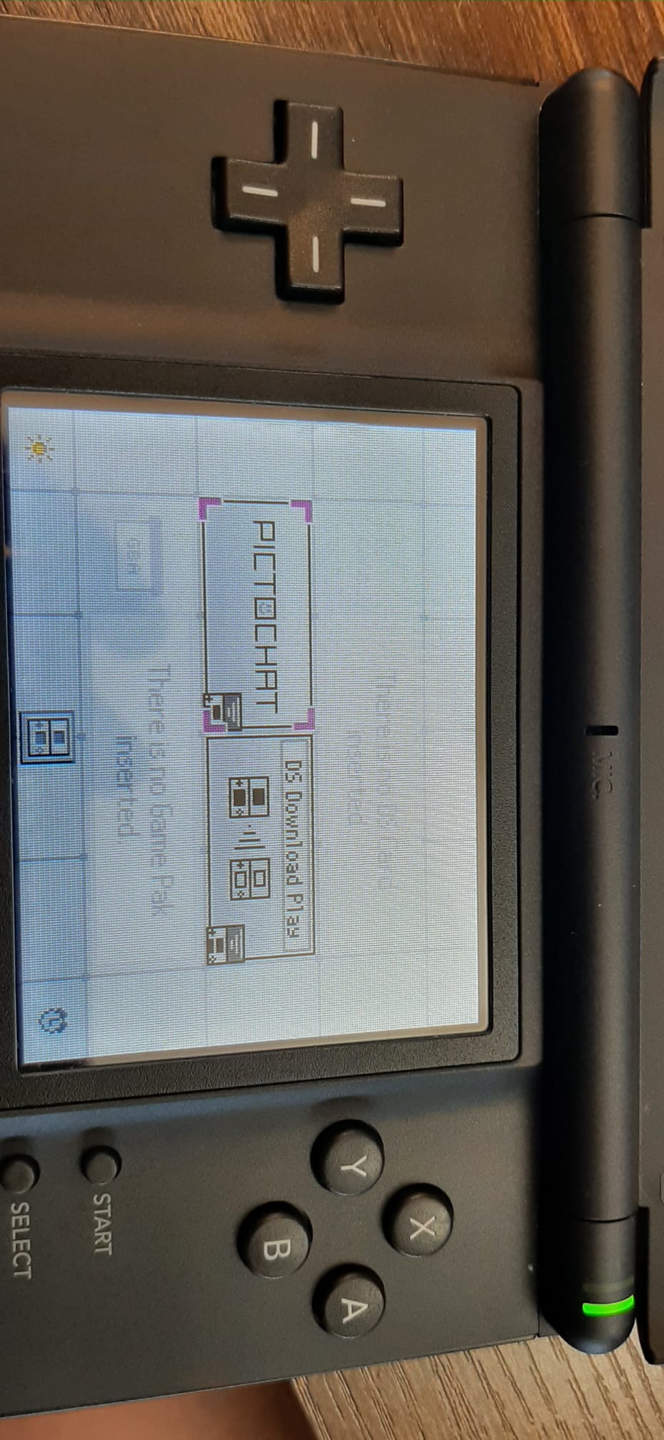

Hi all,
I recenly bought a DS lite to play some pokemon games on, but the R4 card I ordered (gold) does not seem to be working, nor does the replacement (white) that the seller sent. The DS does not seem to recognise the cards, it just says "There is no DS Card inserted.". I have tried various different software packages but nothing has made any difference.
Are there any particular software packages you think might work, or is there something wrong with the hard or firmware? Thanks so much if anyone has any ideas.

Content on micro-SD usually is not important for the R4 to get detected.
Retail games working? If not SLOT-1 connector is dirty or damaged.
R4 often are less precisely manufactured. Sometimes they have contact issues on otherwise working consoles. You could try supporting the connection with paper behind the PCB. First push a little against the cart while turning on. Perhaps it gets detected while holding/pushing.
Try some other DS consoles as well.
Good luck!

Thanks for your reply! My retail games are working, so I think SLOT-1 is fine. I have tried cleaning the cart, and also inserting paper and pressing the cart, with no different results so far.

Hi all,
Thanks again for your help! Just a little update in case it helps anyone else: it turned there was a hardware problem after all. One of the little metal pins on the inside of SLOT-1 was bent in such a way that a normal DS cartridge (with its plastic grooves/forks) would work fine, but not an R-4 card that doesn't have those grooves for the metal pins to slide into. In hindsight this was easily visible when looking into SLOT-1, so I suppose its worthwhile to inspect it before buying a secondhand DS.
After getting a different DS, SylverReZ's software indeed worked perfectly.
