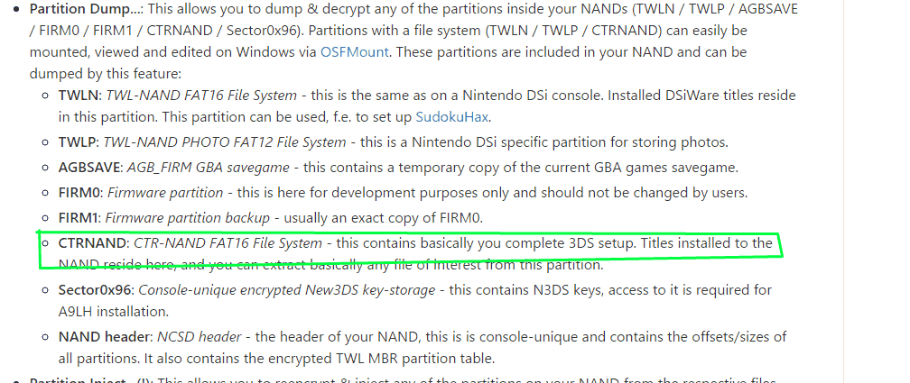

I guess I should have posted a screenshot of what I have.
(Yes I can run windows on my computer as well)
EDIT: I managed to convert them to cia files, but I can't decrypt them. Even with Decrypt 9
EDIT 2: Well, I'm an idiot. They were .ncch filed disguised as .app files. I'm able to extract them.
