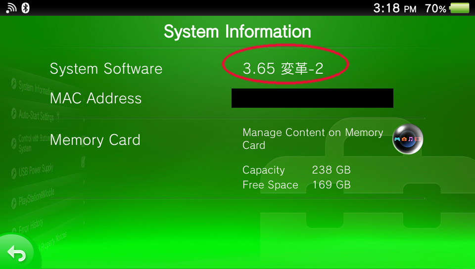

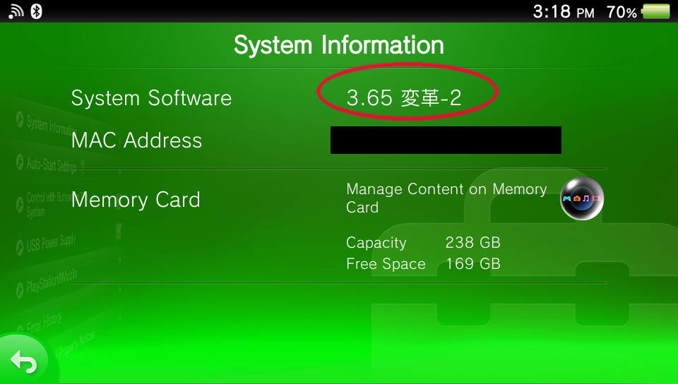

Dude, go into your Settings > System > System Information and take a screenshot of it, and POST IT IN THIS THREAD.
Here is an example:
In the screen below, see the circled part? If your screen has this (3.65 変革-2), then your hack is still there, and you MIGHT be able to salvage this debacle by UNINSTALLING YOUR HACK PROPERLY. If not, and it (likely) says 3.74, try playing a game (a PS Vita game cartridge/chip) on it. If doesn't work, you're SOL. Anybody else wanna chime in on this?

I have downloaded so many games do I have to uninstall the mod properly? Games do run as well, I have install all the games again if I redo it, is there a better method that I can keep the games & also undo hack properly & redo it again?

Hey man it looks like you are in good shape! I say that because of the System Information screen you've posted. YOU MAY NOW BREATHE A SIGH OF RELIEF!!! DAMN, I'm relieved too!!!
