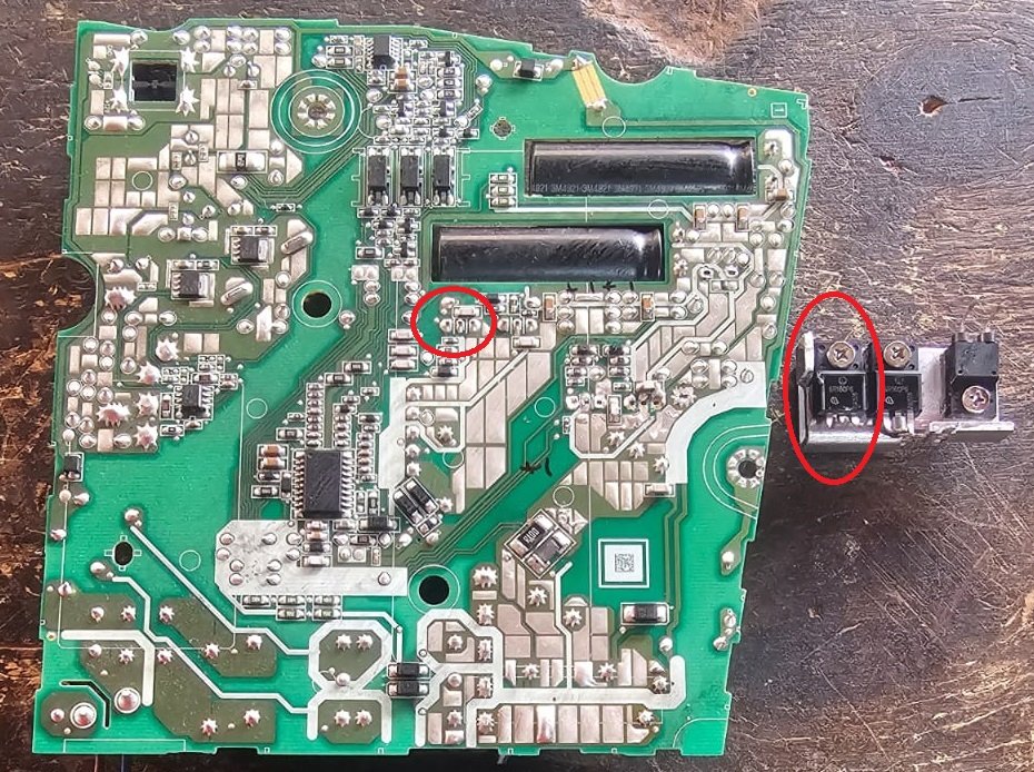

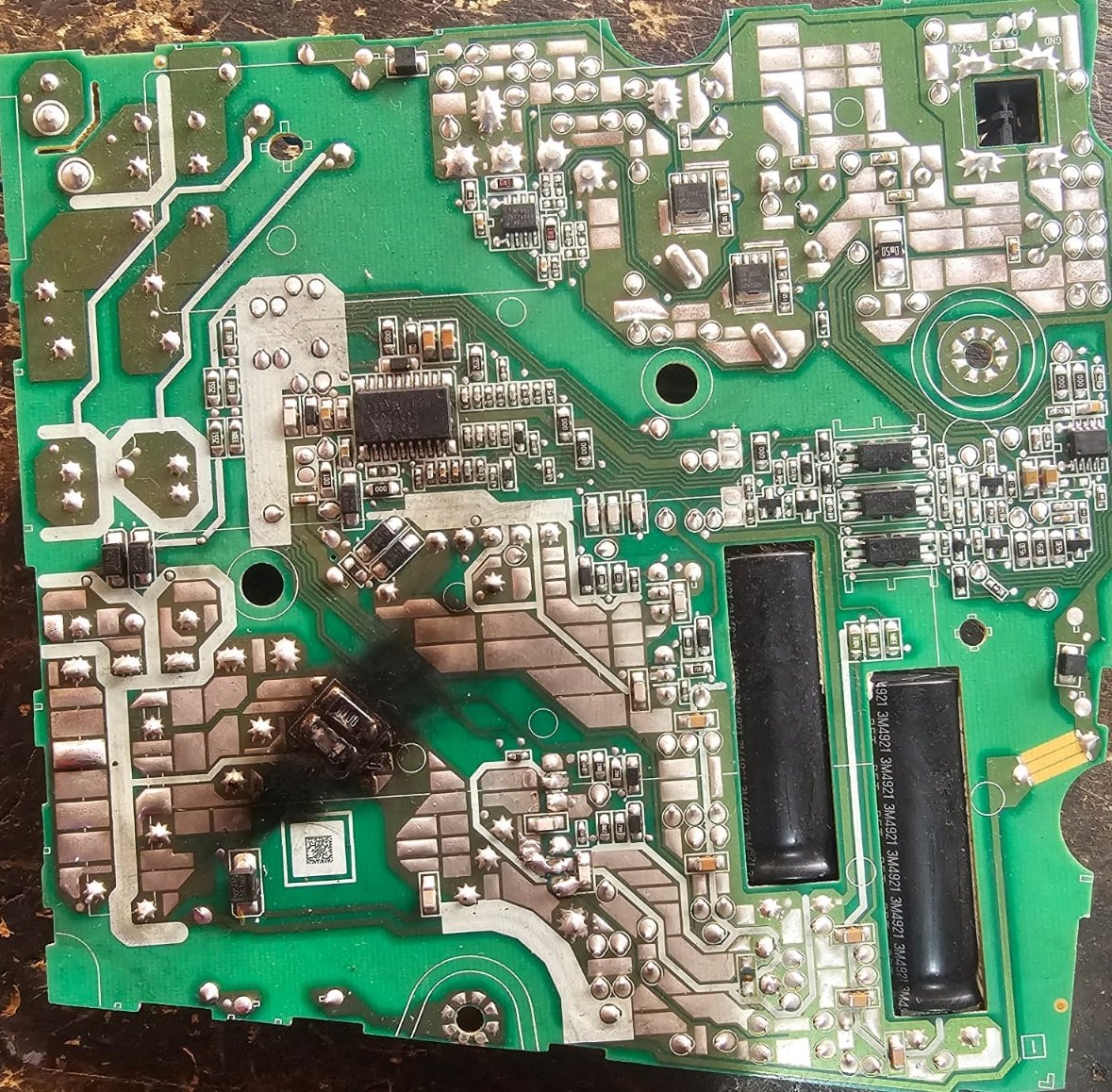

Hi to all!
I´ve a ps5 slim PSU burned, found the short, replace both mosffet, with same part number, connect, and explode again...
Somebody knows, what more component are faulty?
Thx in advice!

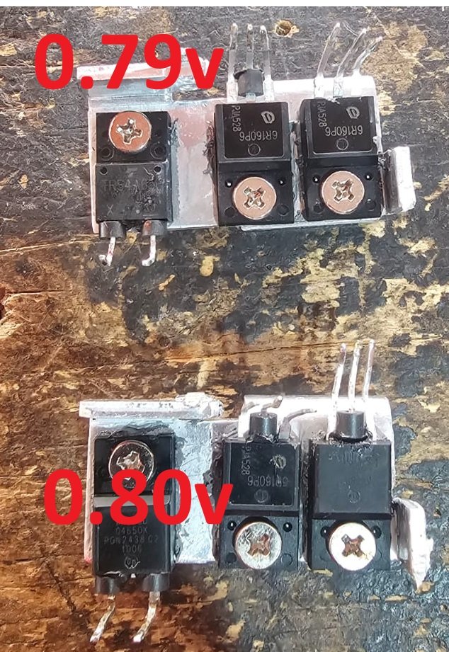

Thx for answer thesjaakspoiler!
Yes, psu meassure apart, 12.15v, ps5 tested with cpu psu, runs without problem
UPDATE:
Have two psu, same problem, i´ve can see, the mosfet in red circle, are in short, in both psu, so, need to investigate that
Checked schotty diode, are good or not?
Google says: "If the diode is a Schottky type, this value is too high (it should be 0.2V - 0.4V), so it would be wrong if it is that specific type"
UPDATE2:
Are mosfet original 60r190p or 60r160p? Somebody know?

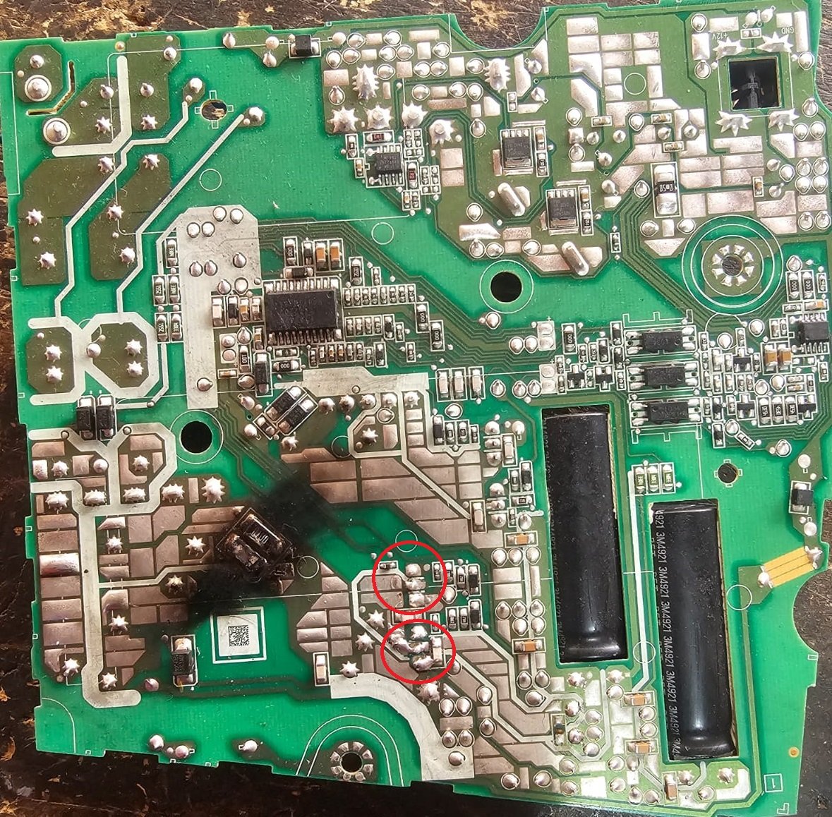

Soldering 2x mosfet 60r160p, replace 2xR R100, output 12.15v
Psu isolated. Hearing a "clip" sound every some seconds
Meassure voltage in mosfet:
Variable: from 280v, going down to 200v, in 200v hear "clip" sound, voltage in mosfet 280v again, and going down again

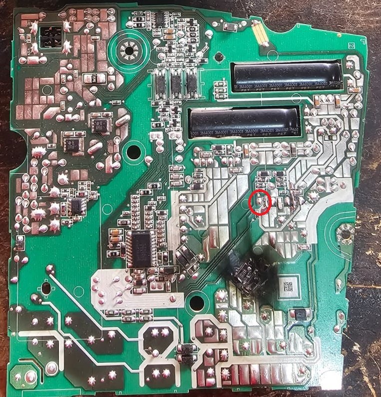

UPDATE:
qn4106 suspicious

qn4106 suspicious
Changed qn4106, with same result, clip sound
Solved!
Bad balance in an optocoupler
