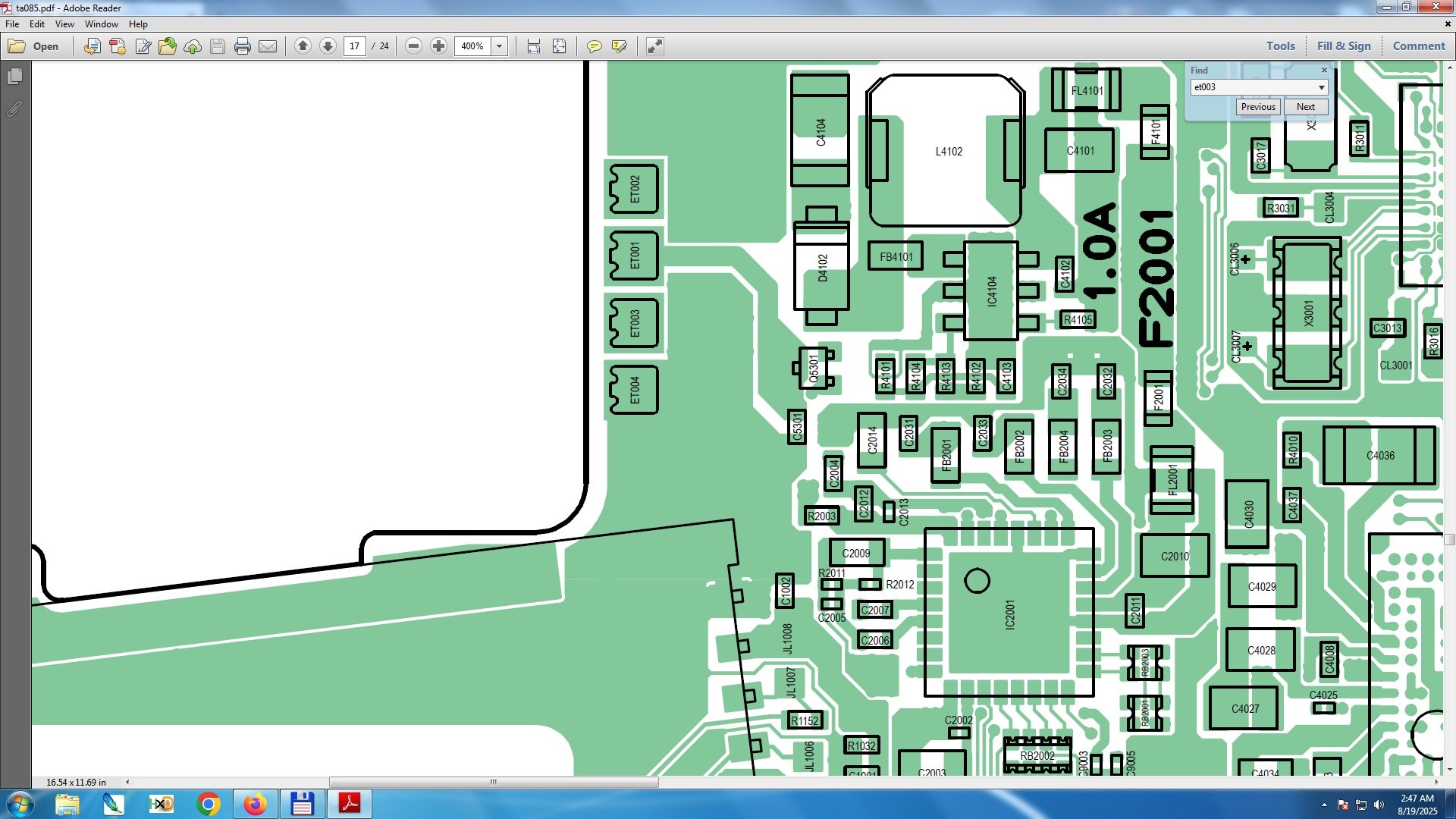

have you put back the conductive film on the analog pins? don't know the proper word for it.
You can find online the schematic for ta-085.
ET004 is gnd and ET001 is vcc. check that.
You should also get some readings with a multimeter in diode mode for the the X and Y pins related to gnd.
