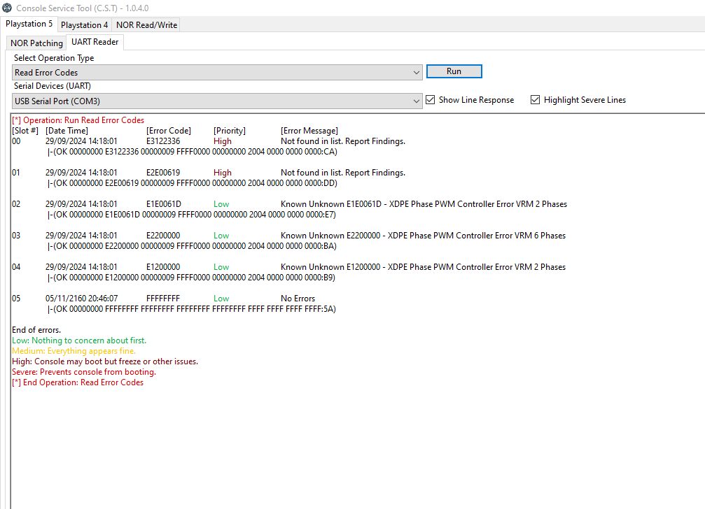

Hi everyone I have a ps5 EDM-033 which a friend gave me the problem is even if it is left on the home screen idling it freezes after 30 minutes with a loud buzz coming from the monitor speakers. There are also no input from the controller or the on off and eject buttons when it freezes, the only way to turn it off is by cutting the power. I connected to a UART and I'm getting a "E1200000 - XDPE Phase PWM Controller Error VRM 2 Phases" and to similar Errors, followed by two errors not found in list. I have attached the UART error report below if anyone has any idea if I have a problem with the Infineon XDPE14286A or the VRM I would appreciate any advice.

Because there is an error for both Phases 6 & 2, I assume there is a problem with the XDPE controller or the power to it.
I would check the XDPE and the bug converter at F7501.

Hi thanks for the reply. I replaced the XDPE chip last night no change still freezing will check the converter tonight, thanks again for your input much appreciated.

Hello, I have the same problem. Error in the XDPE 14286A, my board is an EDM010, I have already checked the F7501 fuse and it is fine, how can we check more things?
