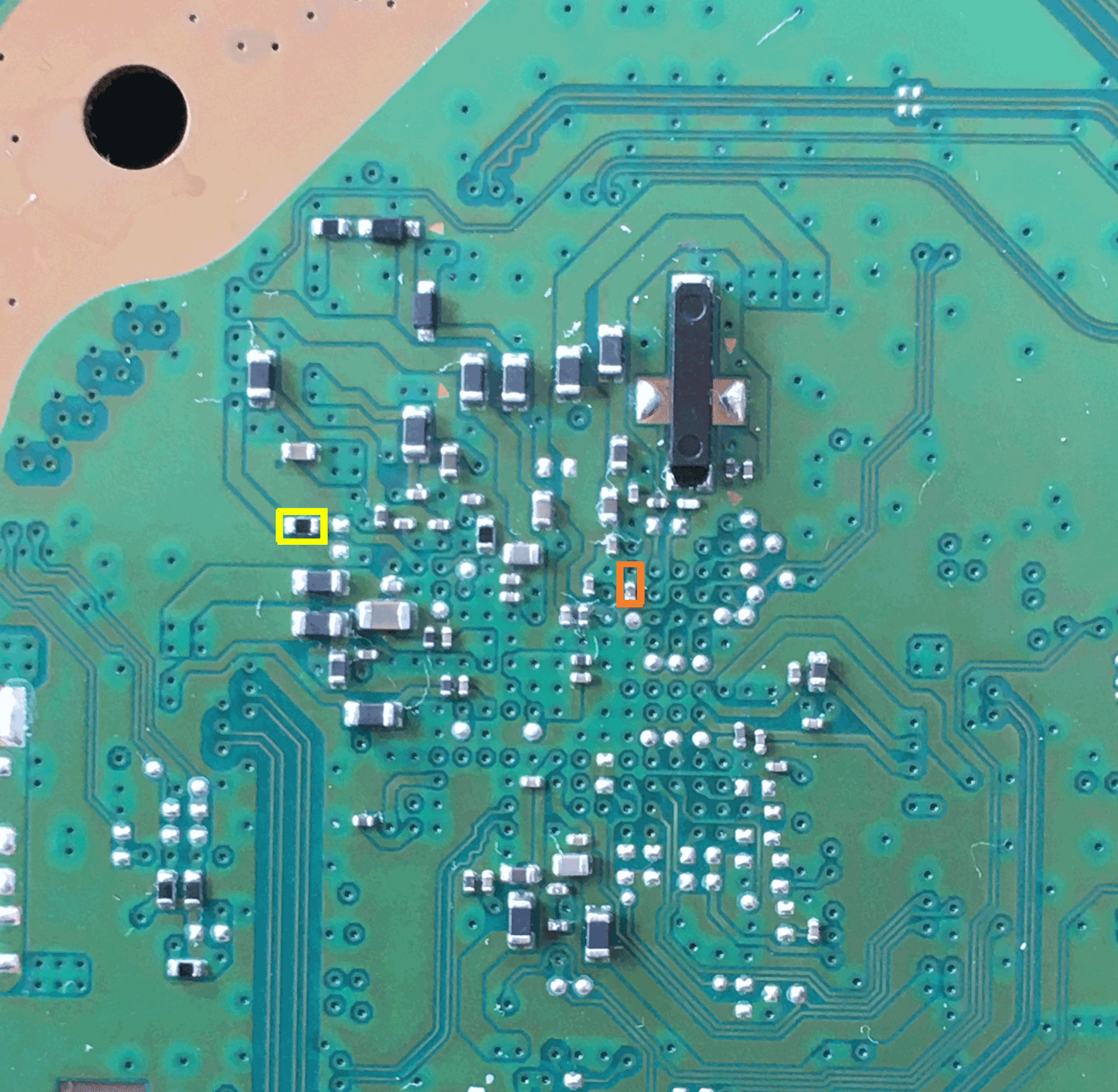

Does someone have an edm-031 board and can give me a reading from a resistor (yellow marking)
and resistance to ground at the 3.3v line (orange marking)?

The little 0-Ohm resistor should read ground if a 61gg southbridge is on the board.
The both bigger components are emi ferrit beads 0603 and feed by the line 3.3V_SS_PG2_CLK.
This line shouldn't be shorted and is generated by the SB pmic DA9065/RT5126 on pin 7.
But to begin with, I would start a bit upstream and check if the 5V is shorted and if so, remove fuse F7003 and check if 5V are back again.
