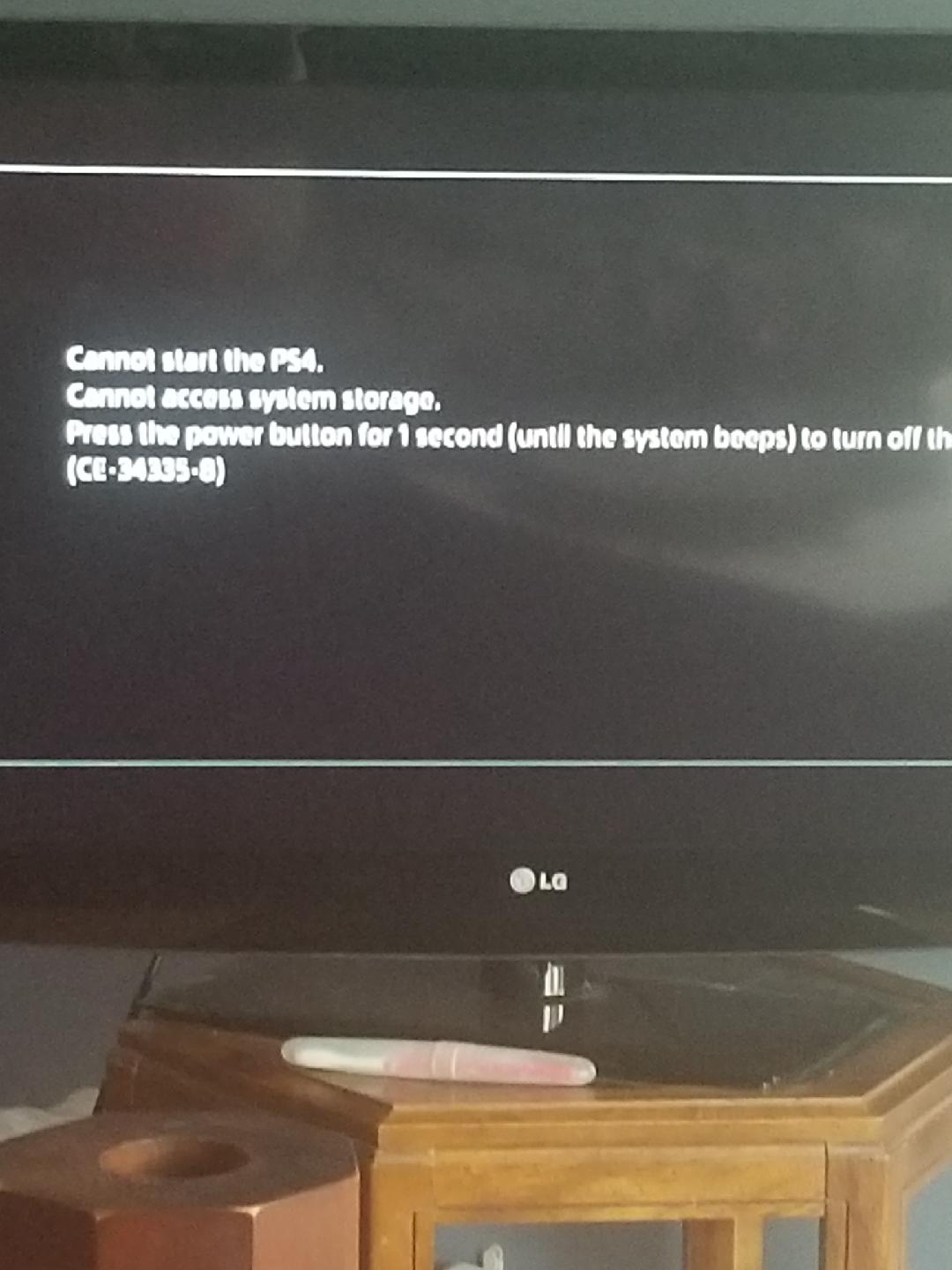

Update. So it came on and had this
So basically the hdd is fried it seems. Wonder if there is a way to recover any data from the drive so her saves arent lost.
Update. So it came on and had thisView attachment 119498
You can use the recovery update.pup file to see if the system and the HDD work. If they are on some specific firmware like 4.05 or 4.55, find the specific recovery file if it doesn't boot without you doing anything.

Thanks for the info i do know its on latest firmware. I'll know more of what i can do once she comes to visit tonight, im hoping i can get into recovery options and just update and save it. If the drive is toast im gonna give her my 60gb thatll fit in it and hope for the best. Thats the only thing i know.

If it is on the latest firmware then just use an ethernet cable and connect to the PS4, and download the recovery file that way, if the drive is dead then the recovery wont be finished, just give it a try.

And if I remember correctly PS4 system os partition require around 150GB, because Im using a 6TB and its real size is 5587GB and after system partition I got around 5.4TB left. So I know the HDD has to be atleast around 250 GB or so, the default one come in 500GB or Higher.

So it asked fir the update file, i had it prepared and it couldn't find it. Now its in a state where the blue light just pulses. I downloaded the normal update. And once it comes back if ever I'll try the other one it had on the page. Any other ideas to try?

You can't use the regular update file that around ~300mb you need the ~800mb recovery update file

Yea it wouldnt accept either file. But i found an odd work around myself.
It wouldnt go past any screens for a while and kept looping back to asking for a usb with the update, even after swapping to the larger recovery pup.
It wouldnt do anything, so i left the hdd in, turned the power one then pulled the hdd out just slighty to disconnect it, and the light finally turned white. I reinserted the drive immediately and it brought up the actual safe mode menu instead of going straight to asking for usb. So i just initilized the drive and everythings working. Now its just her trying to log in. Which is not going well cus forgotten passwords, and resets are taking lol. Thanks for all the helpful suggestions.

Did u rename the file to PS4UPDATE.PUP inside the PS4/Update folder ?

Yea i followed all the instructions the site had, and i had dine that before for an easier ps4 fix for my brother
Probably the HDD is dead then, if it is seated properly in the ps4. If u have external drive caddy u can try to see if windows detect this faulty drive.
On the HDD part you can try EaseUS if you got an external hard drive caddy
