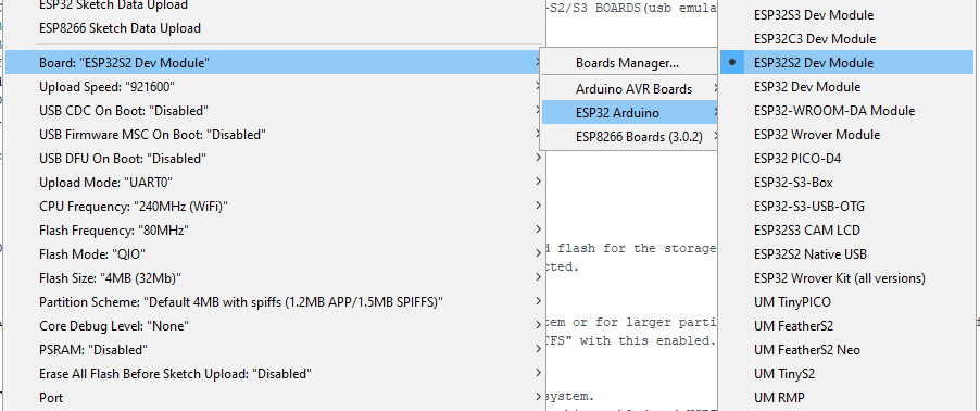

so anyone else flashing any of these .INOs to an ESP32 S2 mini and having it constantly do a "failed to load heap" every time it hits the "load effathax" part? (e.g. - mounting the LOLIN S2 Mini as a USB drive)?
i've gone through the code and added some LED blinking to see what stages it's at and it's passing the enableUSB and disableUSB, so in theory it's copying the exfathax data to the buffer then mounting the device as a USB drive... I'm wondering if it's a board type issue in ArduinoIDE.
I don't use the AP mode; I have it connect to my home wifi and browse to its IP in the PS browser since I DHCP reserved an IP for the board. That shouldn't affect this though.
Using stooged's original ps4-900-u host from source with the exact same setup you have - lolin wemos s2 mini, client mode instead of AP, static IP for the board (but only access it by hostname ps4-web anyway...), connected to the rear usb port. Never failed for me in a weird way. Sometimes out of memory, very very rarely kernel panic.
The exfathax.h in my project clone is 4KB (3.107 bytes), seems to be the pico image then.

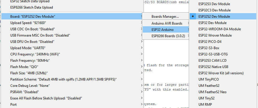

Used these settings for flashing, and "ESP32 Sketch Data Upload" for the initial bunch of payloads (app dumper, db backup/restore):
Once it was setup and running, I never disconnected it again, access via web from computer to upload newer GH versions.
Used these settings for flashing, and "ESP32 Sketch Data Upload" for the initial bunch of payloads (app dumper, db backup/restore): View attachment 340566
I'm curious if it is the board type. I've seen people talk about switching from the LOLIN S2 Mini to the ESP32S2 Dev Module for some stuff. Weird if that would change things enough for this.
I told you, GH 2.1.2 works wonderful, a lot hours with this version using rest-mode and never fail.... :D
Maybe is because this version don't have ASLR disable enable like the others one like @Leeful has pointed... Very good to know it..
BTW: The ASLR disable is necessary for ALL trainer/cheats functionality (Cheat menu) or they will no work...
GoldHEN versions with ASLR disabled ? i dont believe that, at least it is something that should be checked.
Guessing didn't read my post DQW1 working on 2.1.2 and just like 2.0b2 takes longer for web exploit. I also stated that to truly re-enable ASLR you have to do a power cycle so it's not still in memory.
Oh. I regularly updated the Arduino GUI stuff including the board manager things, but since I didn't flash the chip for 9 months or so now, I never even noticed there's a new entry named "LOLIN S2 Mini" 😆
Since you can't really break or destroy anything when flashing (to my knowledge), maybe it's worth a try to do one run with the settings from my screenshot. If it works, sweet, if not, let me know and I can try getting in some time to test it with a second S2 Mini I have lying around that was supposed to be used at my (now ex, lol) partner's place when I would bring the PS4 over.

so after a lot of copy paste flash edit copy paste i ended up unable to use Leeful's index.html (sorry) and had to set the autohen to true. i also flashed it with the ESP32S2 Dev board selected.
i think the usb part was working just fine but it would out of memory loading the goldhen.bin after the exfathax portion. I thought it preloaded the goldhen.bin when it wasn't autohen but I dunno my brain is mush after staring at it for so long. at least i now have a void blink() routine that i used for debugging the steps.
