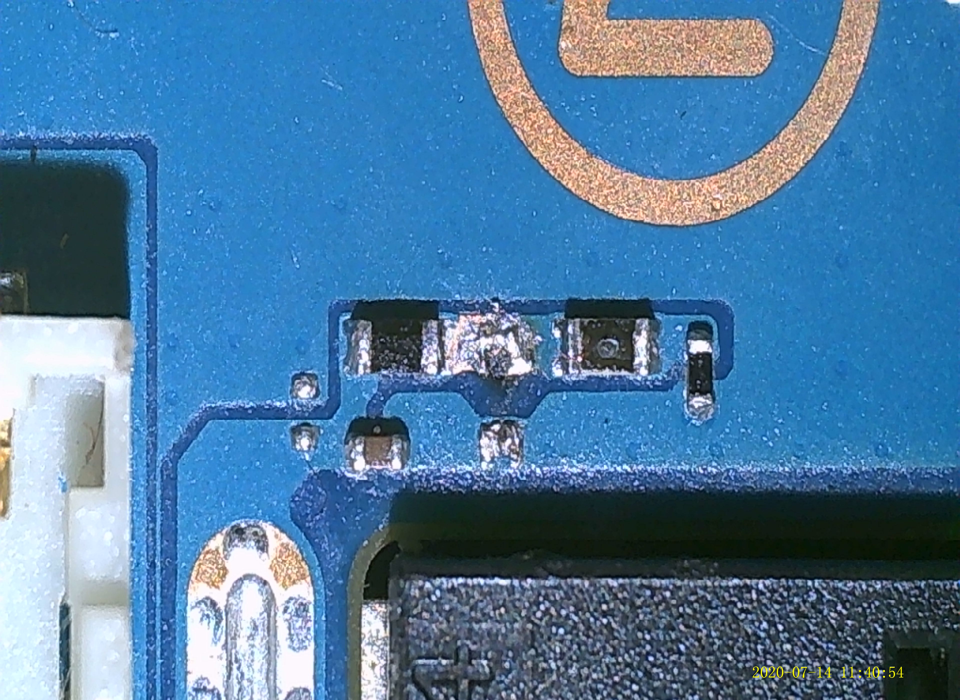

Hello good peoples, PS vita 1000, no audio on speakers or 3.5 mm jack, over Bluetooth works normal,after opening console components mark red on pictures was cracked and burn , i ned help to identify types and values of them, they look like resistors or filters,( they were black color), thanks in advance

They are most likely resistors to reduce volume?
If you want I can measure resistance over your missing components... It won't be THAT accurate as the components are installed. Sorry, I don't have great success desoldering sm components.
I can't tell if they are filters... but I'm guessing that they reduce the volume for the headphones.
After being installed, they should read...
East 9k Ohm
North 9k Ohm
West 45k Ohm
If resistors:
If you read the pads without the component and there is no connection, a resistor with this ohm should work.
If there is a reading of some resistance, you may need to calculate what would result in the above values.
For instance - 4kohm resistor in parallel with another 4kohm resistors = 2kohm
