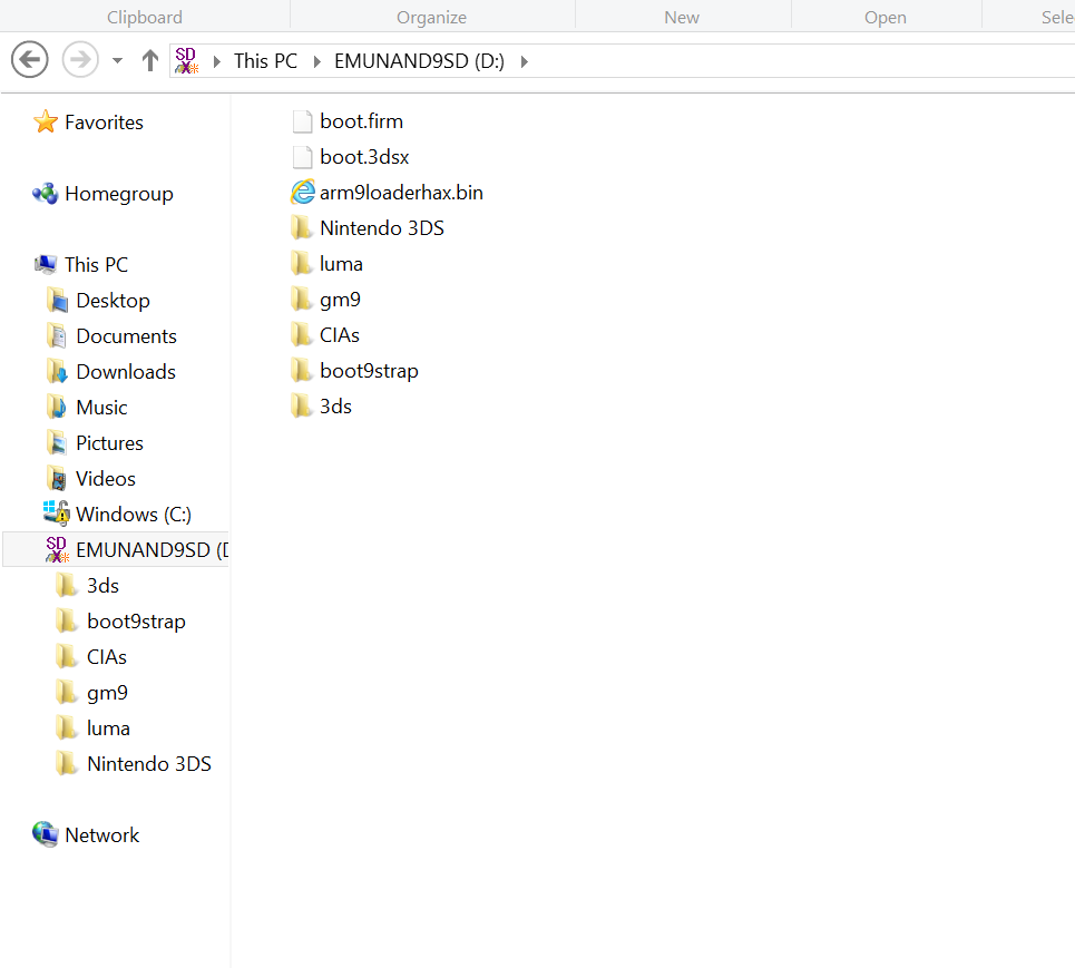

I got to section II but couldn't boot into SafeB9SInstaller. My 2DS keeps booting to Luma 9.1 via BS9. Everytime I turn on my 2ds it boots straight to luma 9.1 and when I press START I get "Error writing the configuration file" and the system shuts off. I can't even boot into sysNAND or Godmode anymore. I have no clue what to try next. Sorry if this post is long, but I just wanted to know if it's possible to bypass Luma. I attached a pic of my sd files and I can post pics of old files backed up before formatting if needed. Thanks

I deleted the arm9loaderhax.bin but its still booting to Luma and getting the writing configuration file error. Do I have all the right files?

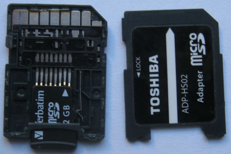

Such an (passive) adapter does not have anything that can fail in an electronic sense. Contact issues and the "write lock" slider not staying in place - that's all.
(Do not try to open a working adapter. It will most likely break.)
