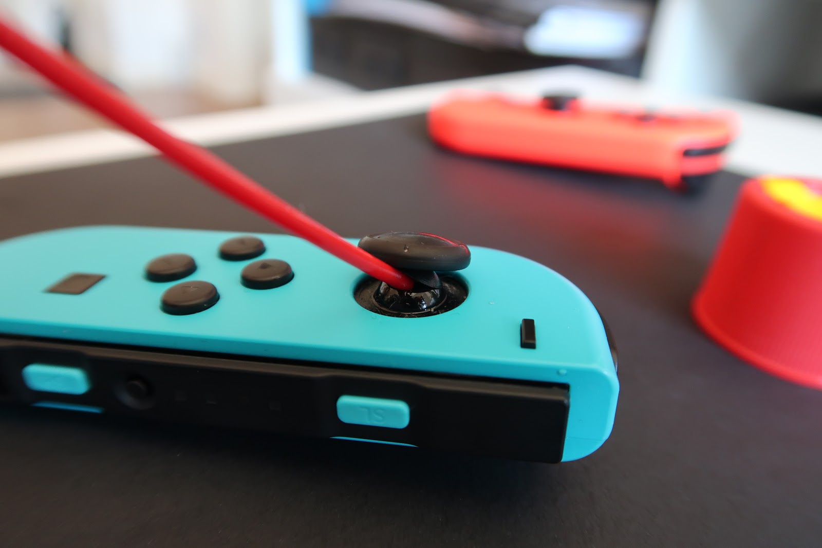

I just had joydrift in a replacement joystick. I was able to peel back the rubber at the base of the joystick. I got an eye dropper and 99.9% isopropyl alcohol. Drift is now gone. Maybe this may be a solution for you. I didn’t have to take anything apart to access the base of the joycon.
right here
WD40 may also work. I’d try this before anything else. It may fix your issue. The rubber is very soft, so don’t be too rough. After you insert whichever fluid you used, work the joystick all around and press slowly to really let the liquid soak in.

Thanks a lot I'll give it a try, I appreciate the photo.

I did this a couple of days ago and I don’t have drifting any longer. Since I noticed I was able to correct the drifting with the isopropyl alcohol, I realize that may have to do this again. I’m pretty sure that if there was any oil or grease inside the joycon, the alcohol may have dissolved it. If the issue comes back again, I’ll spray WD40 in there. So far though, the joystick feels smooth.
