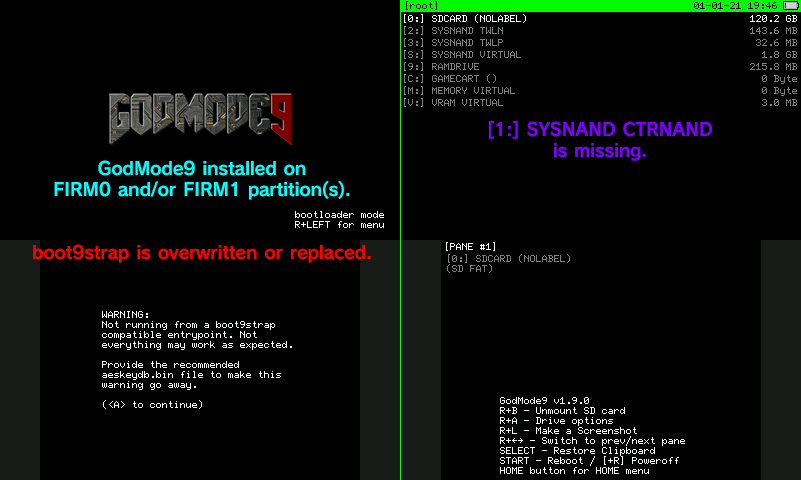

yes i have done all the previous steps and updated gm9. when i boot up the new version it says not running from a boot9strap compatible entrypoint and when i try to fix movable.sed KeyY it says 1:/private/movable.sed file is missing. I don't know if this matters but all there is in my sd card is the Nintendo 3DS folder, the gm9 folder, and the luma folder which i had to make. Also it boots up to gm9 even if i just press the power button without doing anyhting else

You mistakenly replaced boot9strap with GodMode9 on the 3DS system's internal nand stoarge. To fix this, reinstall boot9strap with one of these methods.
-or-
  • GodMode9 → press (A) on boot9strap.firmFIRM image options... → Install FIRM → Install to both
    • You may want to first verify that the FIRM is correct using the Calculate SHA-256.
    • [version 1.3 | SHA-256: 79C68585B4BA1D7C4A91B858861553E768C6576B92E303810B33219736B3598B | size: 30 KB]

The reason why SafeB9SInstaller failed to install sighax is because the boot9strap *.firm and *.sha files at the sdmc:/boot9strap folder are missing.
Once B9S is reinstalled after this long winded detour... revisit and continue at step 7.
