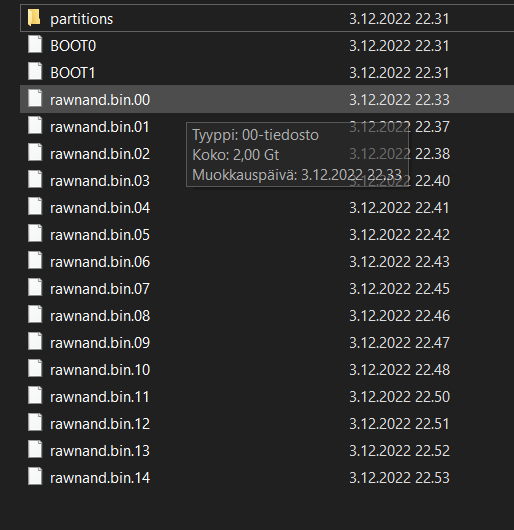

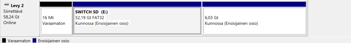

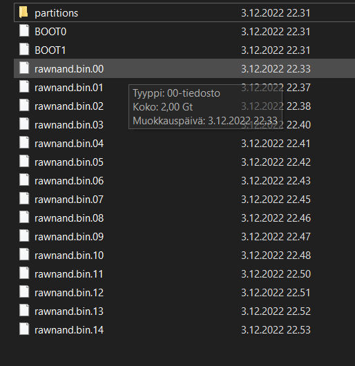

Please post a screenshot of your /bootloader/backup/xxxxxxxx/restore directory.

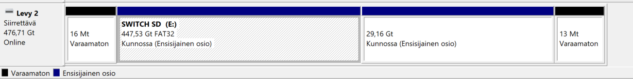

E: also a screenshot of your SDCard in Disk Manager on your PC.

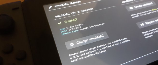

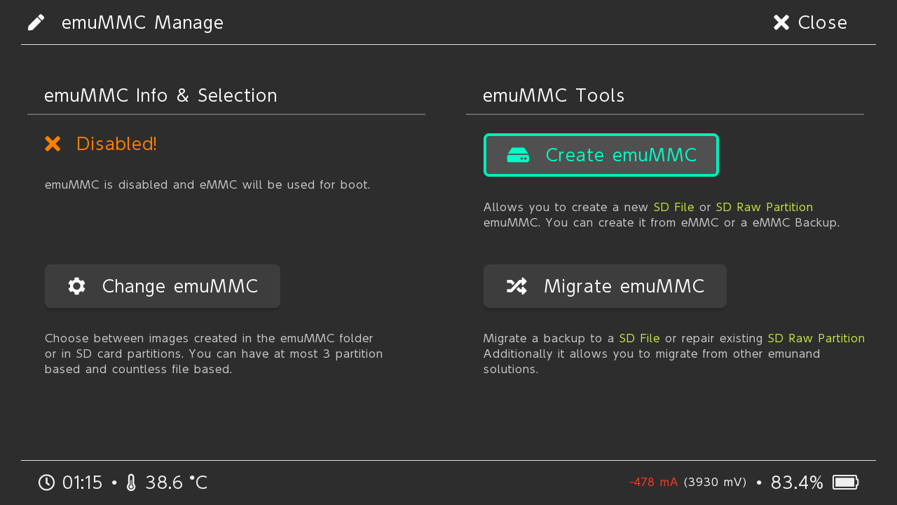

And please post a screenshot of the emuMMC page in Hekate (when you boot back up)

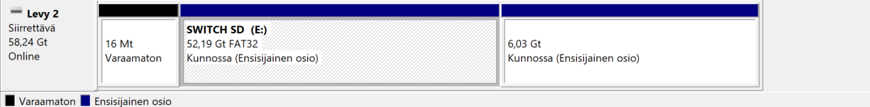

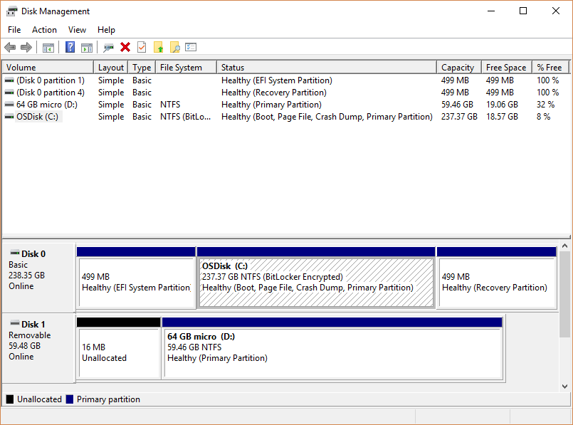

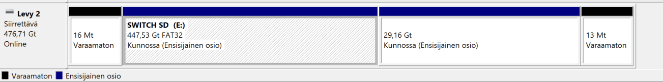

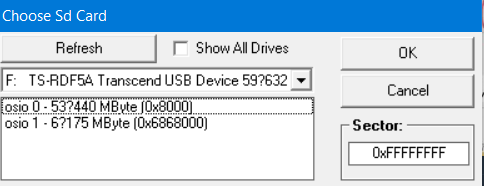

When you open the Disk Manager app on your PC, does it show 2 partitions on you new SDCard? Please take a screenshot of this.
It will look something like this:
This looks normal and what I would expect.
This does not look like a partition based emunand. It only has 6G for what would be the emunand.

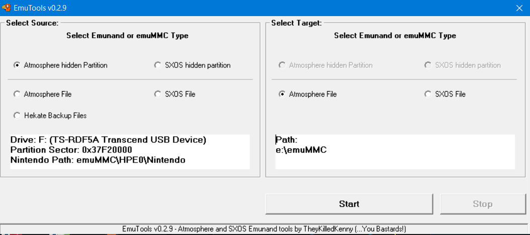

Let’s use the EmuTool version of this guide:
https://rentry.org/EmuNANDNewSDcard
Try using the following source and target. There’s no need to redo the file copies…just download the tool and copy emunand from 64G card to 512G card.

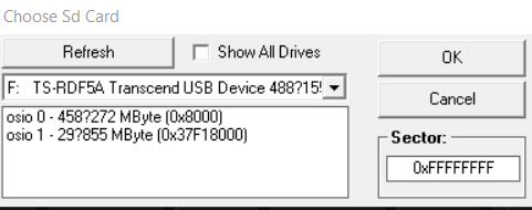

Put your 512 card in and select the same options and have it copy your files based emunand on your 512G card to your partition based emunand, also on yiur 512G card.

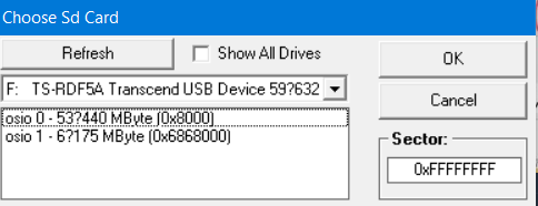

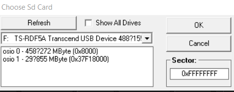

E: for the target you will select osio 1
Okay, i think you mean that i use emutools to copy.
it shows this again and not sure which i choose. After I choose the correct one and I press start?
should it look like this?
That is correct, we want to use Emutools to copy FROM Atmosphere Files TO Atmosphere Partition. For the target you will select osio 1.
@binkinator
Now i understood fully what you ment.
Problem is that emutool gives me error "boot0 not found"
source is emuMMC\RAW1\nintendo
so does that mean i haven't used file based emunand?

3) a screenshot of Hekate -> emuMMC
