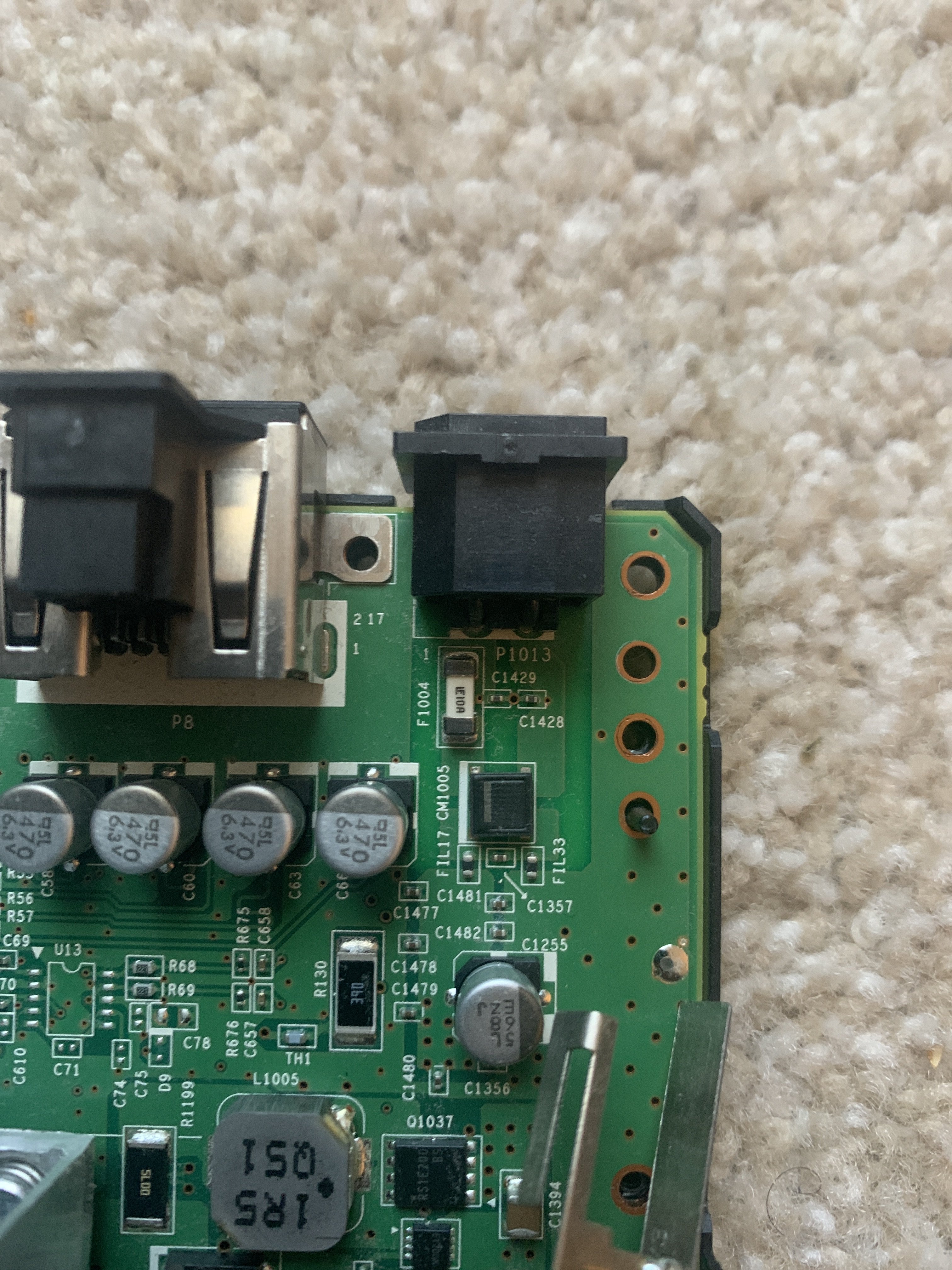

update: it wasn’t the AC adapter, as i borrowed a friend’s and nothing changed. I do possibly have a lead though, I think the fuse may have blown (as indicated by the blackness surrounding it)
Why are the AC and sensor connectors black? Did you replace them?
A black power socket usually indicates it’s a later-made Wii U. For example, the Mario Kart 8 bundle from 2014 with the game pre-installed, had a Wii U with a black power socket.
I’m aware that it’s soldered on but the 2 connection points (which are typically gold-colored) are completely blacked out which makes me think it’s blown

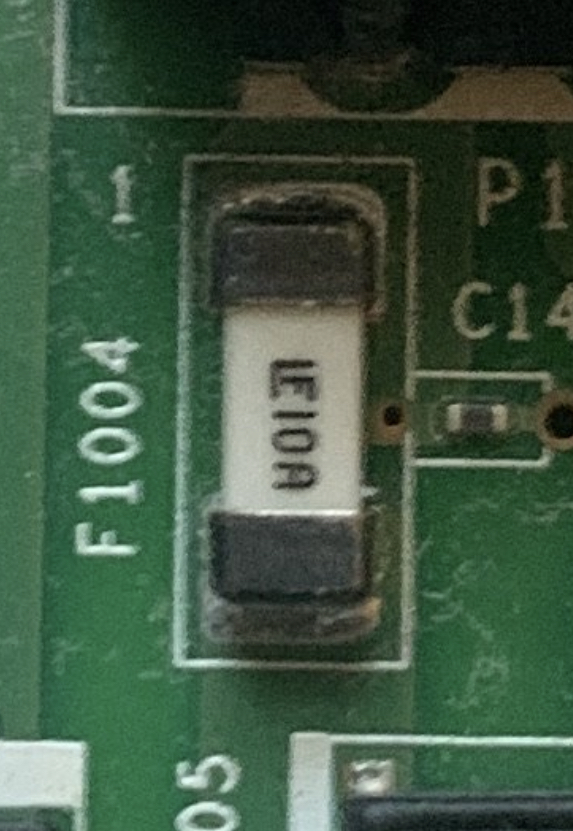

edit: found an image of similar/possibly identical fuses
Edit 2: after using my brain I saw that the Wii U’s power supply uses a lf10a fuse, I’m going to get a bunch and replace the one already there to see if it fixes anything
