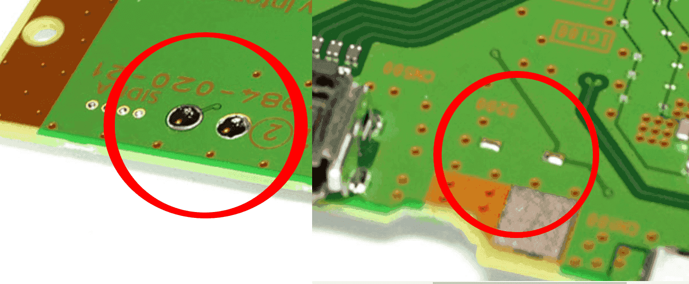

you got a photo of the other side
Here you are i scanned it yesterday. tried scanning the front but it was blurry for obvious reasons involving usb clearence it was kinda derp moment tbh

When you hook up the ps classic on a windows pc and connect the big solderpoint with 2 wires or with a tool, it will be recognized as a tp link fastboot device and a yocto device
Thanks for confirming that. Im going to bum a lift to ye old hardware shope to grab some wire striping tools and a dummy plug tomorrow and make myself a port. Functionally useless till we get a bootloader but itll happen i have faith.

Just to mentioned this works without soldering by using the power usb port.
Wait do you mean these test points by any chance i thought you were talking the serial port.
That's kinda nuts if that's the case.
If not sorry for being the annoying guy that asks too many questions.
Reactions: TonyBiH and Hekel
Yep those (only the left ones on the picture) connect the ps classic to youre pc and the led will start flashing slowly red. Then connect those points and wait till the pc installed all drivers. After that you can release the connection of the points.
