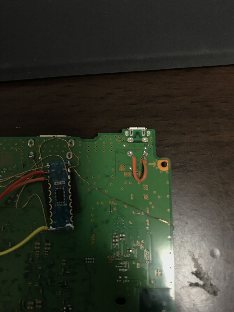

kind of pointless now but the key to reliable uart connection is to bridge 2 points under the motherboard nearby the actual usb port. go figure.

finally i got it to boot consistently. stupid bridge on side A of the board.

can you put games on it and play them right now with ease? yes with some soldering and a uart adapter as the current payload script that yifan lu released it allows you to login as root on the console. (cygwin and certain files are needed to be compiled to create this payload)
Can any uart adapter be used at this time to do the shenanigans some youtube folks are doing? no. you will need one that supports a baud rate of 921600 which is pretty high and not all uart to usb adapters works. however you can use something like this:
https://www.amazon.com/MakerSpot-FT230XS-Serial-Adapter-Dongle/dp/B01J9G3OAS/ref=sr_1_1
oh also two points need to be soldered under the motherboard to enable the serial console.
also at this time basic linux command lines knowledge is needed once you have gotten full terminal access.
hope that clarifies where things stand for the newbies.

good work do have any photos of all connection&solder points on playstation classic. Thanks in advance
the uart pinout should be self explanatory.
oh also do not solder the uart 5v line to the motherboard, you can kill it! do not do it. you just need the rx tx and gnd. also the jumper on the uart to usb should be set atleast to 3.3v. you may end up doing damage at 5v.
AS A MATTER OF FACT THIS IS ONLY EASY FOR PEOPLE THAT HAVE LINUX AND UART EXPERIENCE. I DO NOT ADVISE THIS FOR NEWBIES
the bottom pad that needs soldering you can disregard the uart as that can be soldered on top (all you need to solder is the U shape orange wire) :
picture is courtesy of bakueikozo and can be found at this blog here:
http://honeylab.hatenablog.jp
