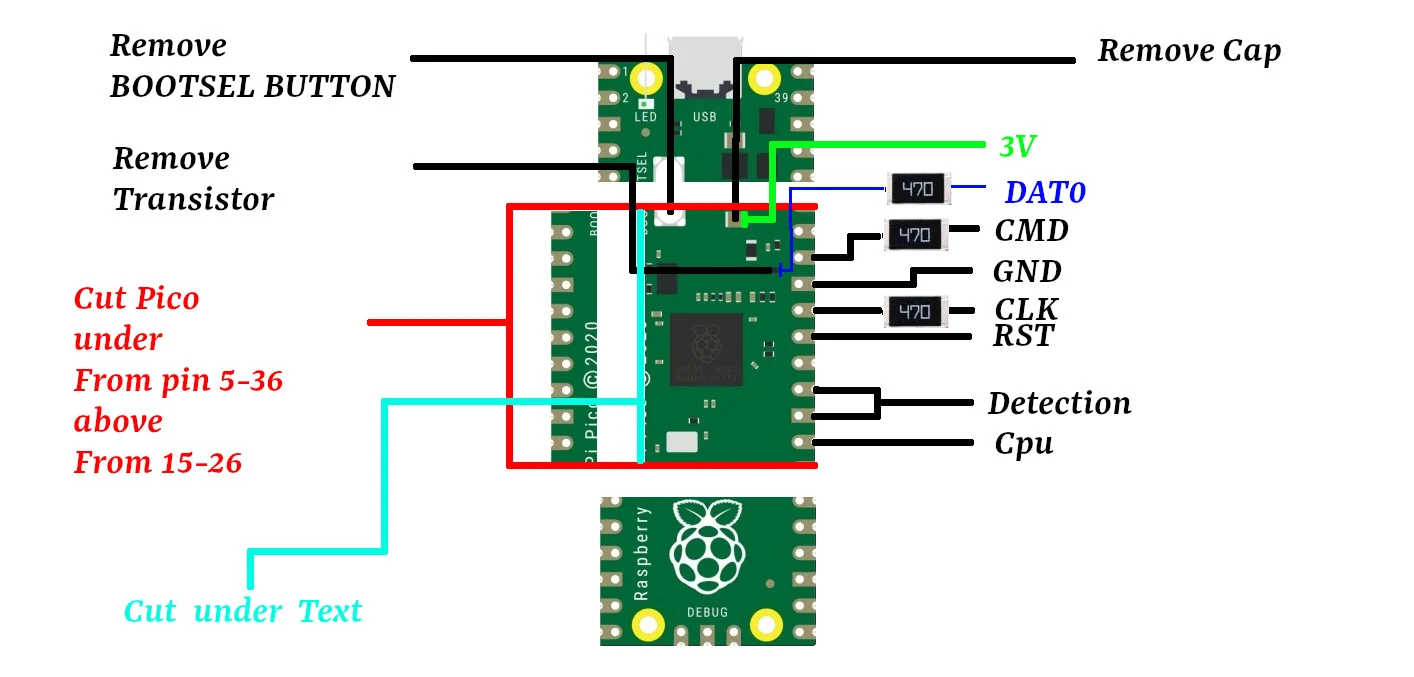

How can programmer raspberry pi pico with fw 2.74 firmware. Befor cut it???
I use nuke flash after that fw 2.74 firmware then no lghit. Is it fine???
why are u using 2.74 its depriciated so dont use it use 2.73 if ur having issues afterinstalling it and cuttign the pico ur gonna have a hard time with reflashing it
