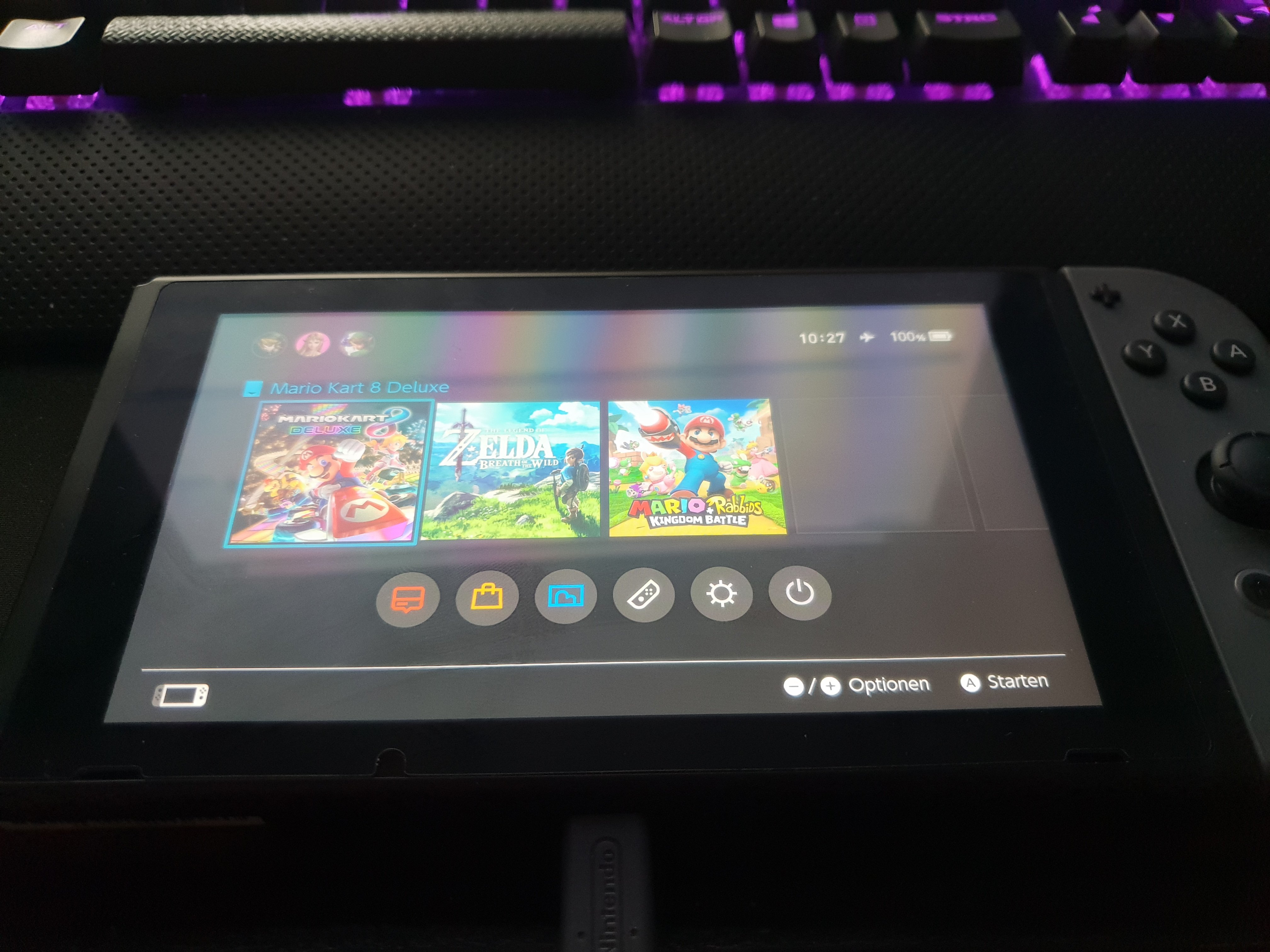

The switch is alive again, thank you rajkosto for all the hard work and time and for the patch.
And no i didnt faked the picture
This clever fellow somehow got a program on his computer to try and "fix" the non-compliant eMMC GPT after he had it in UMS mode (nintendo doesn't care so they swap the partGuid and partType fields, as a consequence something that is supposed to be unique, isn't, making it non-compliant), restoring the stock GPT to his switch fixed it (he says the culprit might be the ext2 volume manager from the program he installed to be able to mount ext4 partitions on his Windows PC, that may or may not be the case)
If you also managed to do this, go get gptrestore from https://switchtools.sshnuke.net and run it (Source code available at https://github.com/rajkosto/gptrestore)
