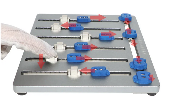

Hello, I wanted to start a discussion about PCB holders for Nintendo switch.
For example, to swap the USB-C socket or for other work on the motherboard.

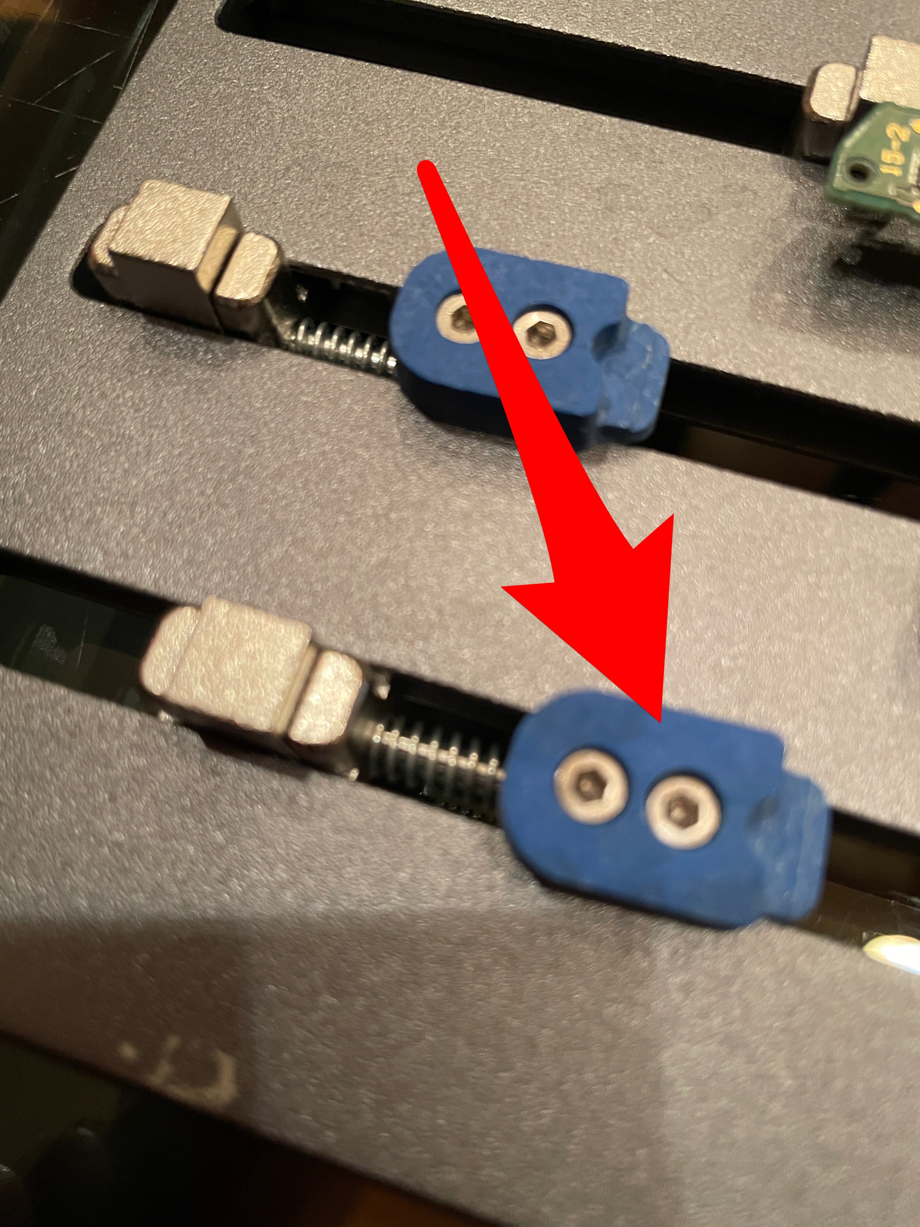

I am currently using the holder shown in the first and second photo.
It is probably also suitable for hot air, the blue components should probably discolour if using with hot air.
Would this holder be too flat for you to work with?

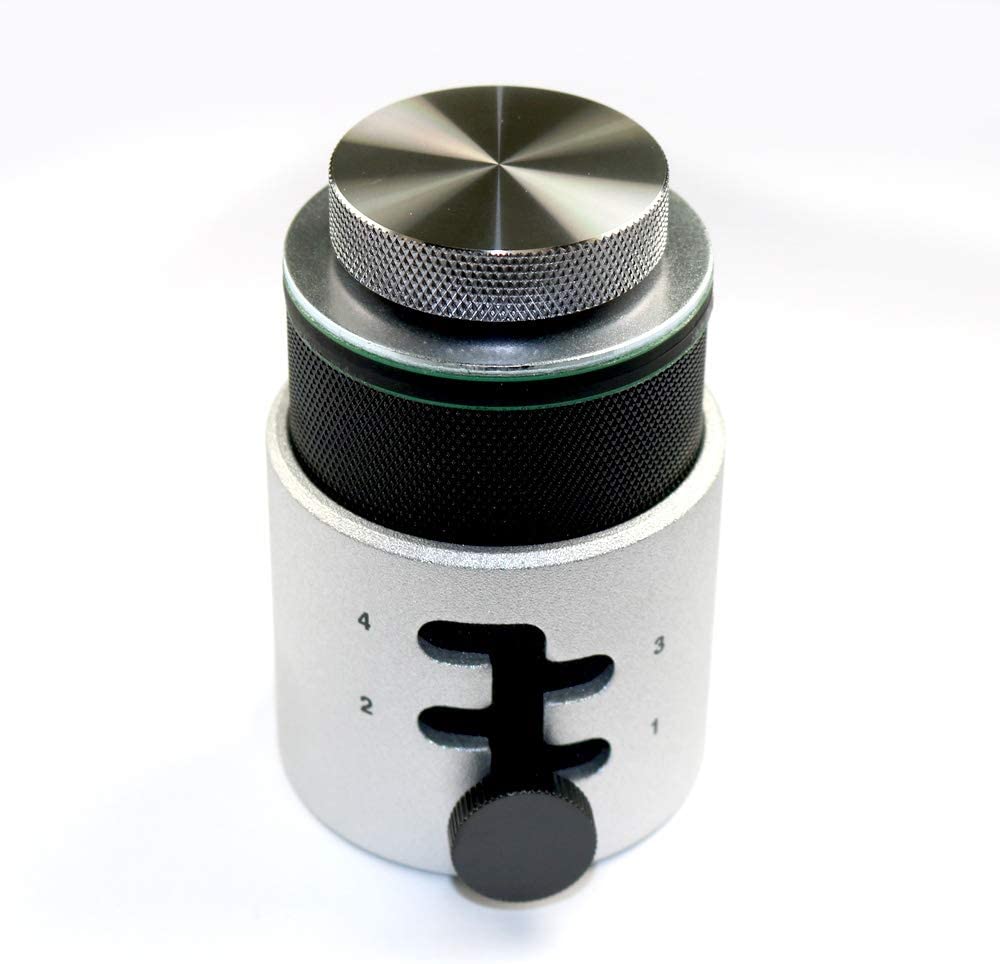

I have another holder in mind. (Photo3+4). It is to use with small and big pcb. Depending on the number of this holder.
Do you think this is better for soldering with hot air?
What are you using?

Pic1&2 would get hot on the aluminum surface after few hot air run, so they are not hand touch friendly but workable.
pic3,4 edge clamp IMO is good tool if it fits your microscope working range.(Too tall for me though)
That’s why the dude is wearing the asbestos gloves, duh!
I agree…big and complex. They aren’t going to work very well once you start dribbling flux all over them (or maybe I’m just messy?)
