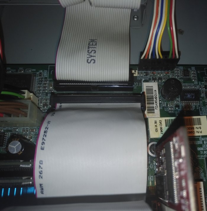

99% of floppy disk readers use IDE connections.
No, they use floppy connectors, which stand to IDE like the expansion ports on the original Raspberry 1 models stand to all newer ones except for the part where the bigger connector is not a compatible expansion of the older one :D
I'm talking about the older models, not the new USB ones or whatever. The floppy drives from back then used IDE connection with a cable that had that "twist" on a part of the cable (6 of the pins) at the "master" side of it if you know what I'm talking about. What you are thinking is the POWER connector, which is that unique and incredibly annoying because of it's shape 3-pin one that is the most hated connector after MOLEX (if you think this isn't that bad a connector, you haven't worked with enough PCs)...:angry::glare:
Yeah, I mean that one, it's shorter than IDE (34 or so vs 40 pins):
(fun fact, the original floppy controller was designed to support 4 drives so they had jumpers to assign them a number 0 to 3, then when PCs with at most two ones became the clear leader they started making drives fixed to 1 and using the twisted cable to make the one at the end 0!)
I'm used to saying IDE to refer to PATA (which covers all those connectors), easy to cause misunderstanding I guess, so oh well:P
